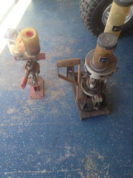

    When college starts and i get my schedule down i'd like to start reloading some 12 gauge trap loads, my grandpa has a reloader that he'll let my use.
    My list so far is
    hulls
    primers
    powder
    shot (#6 and 7 1/2)
    and wads.
    Am i missing anything?
    this is the reloader (i think)

    Steelshot requires a different steel reloader or a conversion kit on your current reloader.
    First thing you need to do is figure out which mec model you have and read the instructions on how to adjust it. Plus you need to make sure you have the right charge bar and correct bushing for whatever powder you use. Reloading shotshells is different the metallic reloading because each hull calls for different components namely wads, powders, and primers. Its not very difficult once you get started but be careful and do lots of research.

    Thanks for the info, i'll be picking up some books in the near future.

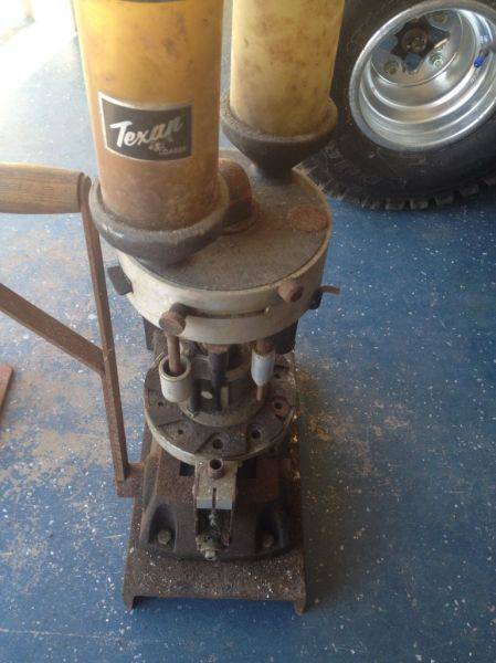

    I bought home some reloaders today, one is a MEC, but the model # is worn off (i think, i'll clean it up in a little bit and inspect it) and the other is a texan, according to my Grandpa it's multi-gauge, and he has all the dies (somewhere).

    On the MEC the model number should be stamped on the base most likely between the mounting holds. It looks like it may possibly be a MEC Jr

    It is a mec JR, pre-85 so the parts are expensive, this one is set up for 410 and i want to reload 12, so it'd be $180 for gauge conversion dies, or i can get a used mec jr mark v for $125 locally.

    If you are going to get a mec. Look for a sizemaster since it will resize the shells for you. if now the mec jr you are looking at will work as well.

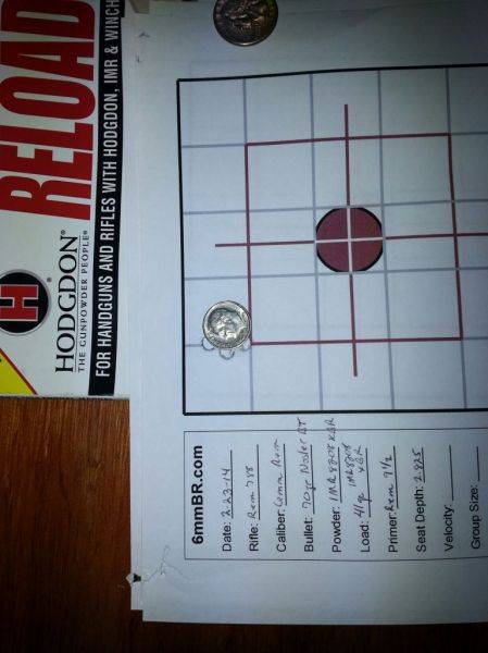

    70 gr Nosler Ballistic Tip, 41.0 gr IMR 8208 XBR, Neck size only, Remington 9 1/2 Large rifle primer. Not bad for an old rifle. Rem 788 LH 6mm Remington.
