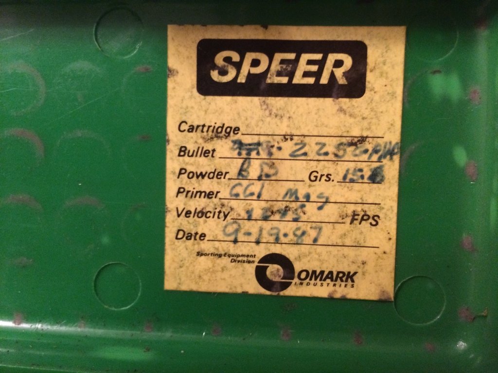

    Ok guys, I'm looking for a specific bullet. I inherited a ruger black hawk in .45 colt from dad and along with it was a box of reloads. The reloads used cci mag primers and blue dot powder. I've figured all that out. What I haven't figured out is what bullet it is. The data says 225 grain and then it gets illegible (old label). I think it says ghhp or possibly chhp or hcsp or something along those lines
    Any ideas?
    I want to copy dad's load for some ammo

    Oh, I stupidly shot the ammo, so I can't pull the bullet to figure it out. I vaguely remember a semi jacketed hollow point but may be wrong

    Could be in trouble if you can't tell whether the first letter is a G or an H. RNFP would be my guess for a 225 gr 452 mold. How old are the rounds? Do you remember if they were jacketed or cast?

    Definitely jacketed and definitely hollow point
    And probably 80s, they remind me of the 240 gr jacketed hollow cavity by Sierra

    Maybe y'all can help me decipher it

    Looks like GR HP, as in "grain hollow point".

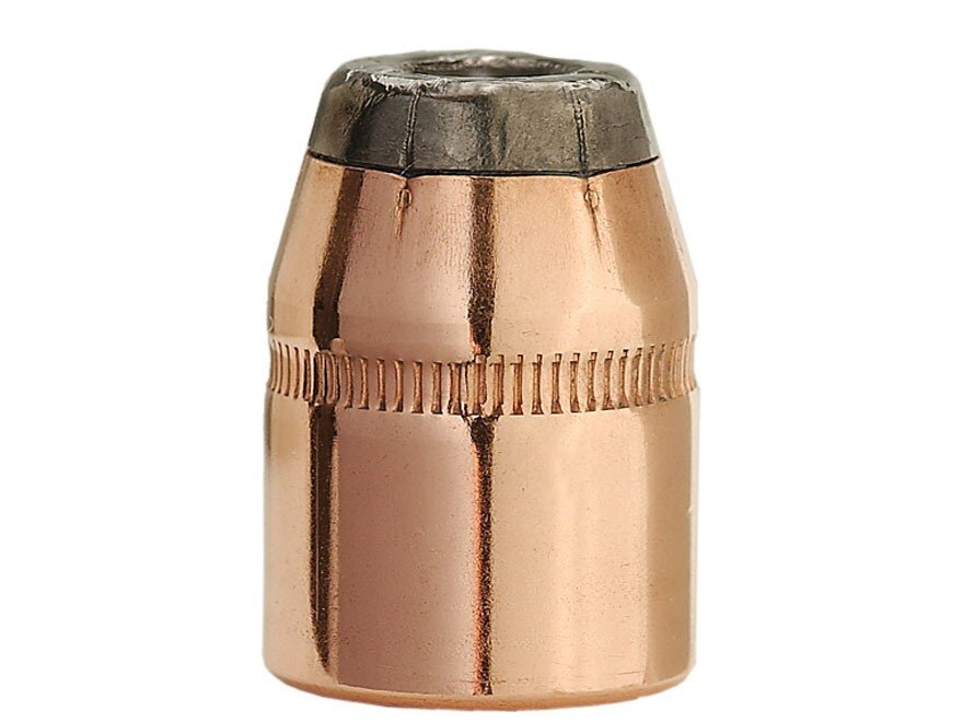

    K&N Cold Air Intake, Warn Winch and Bumper Guard, Wet Okole Seat Covers, Undercover Bed Cover, TRD Kenwood Head Unit, Infiniti Speakers, JL 13.5 inch pancake sub
    Not quite, they were visually very similar to the 240 grain hollow cavity like this
    At worst I'll get a bunch of these 240 grain rounds and hot rod them

    You're probably better off with a jacketed bullet if you want higher velocities. The plated should be used for lower velocities.
