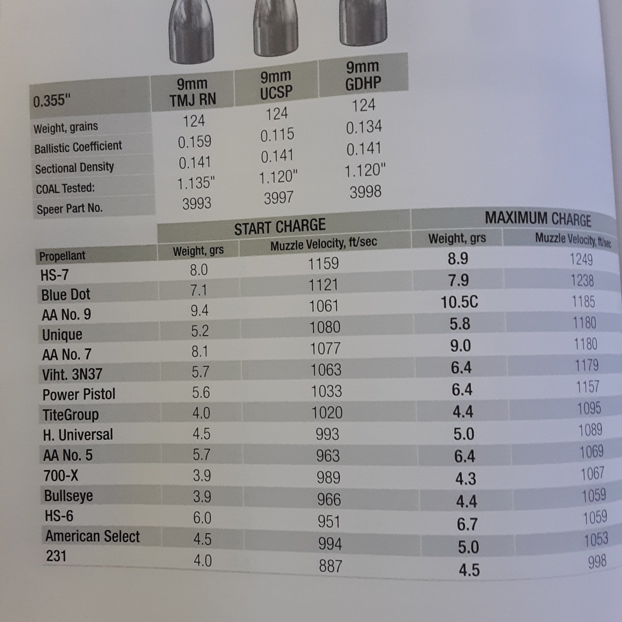

    Could the 9mm charge be all over the place because of bullet diameter?
    I thought 9mm was .355.
    I am just getting into the 9mm reload too. Told myself long ago i was not reloading 9mm...lol.
    Found 2, 20 year old unopened 1pounders of #5 and #7 in the back of my reload stash!
    These Berry's 124 RN bullets i got are .356 had me thinking it may increase pressure slightly over a .355? .355 seems to be what i pull up in reload data.
    My old Speer book says Unique for a 124gn RN is 5.2-5.8 grs. With a .355 dia bullet.
    Nosler 4.6-5.6 grs
    https://load-data.nosler.com/load-data/9mm-luger-parabellum/

    Same in my book

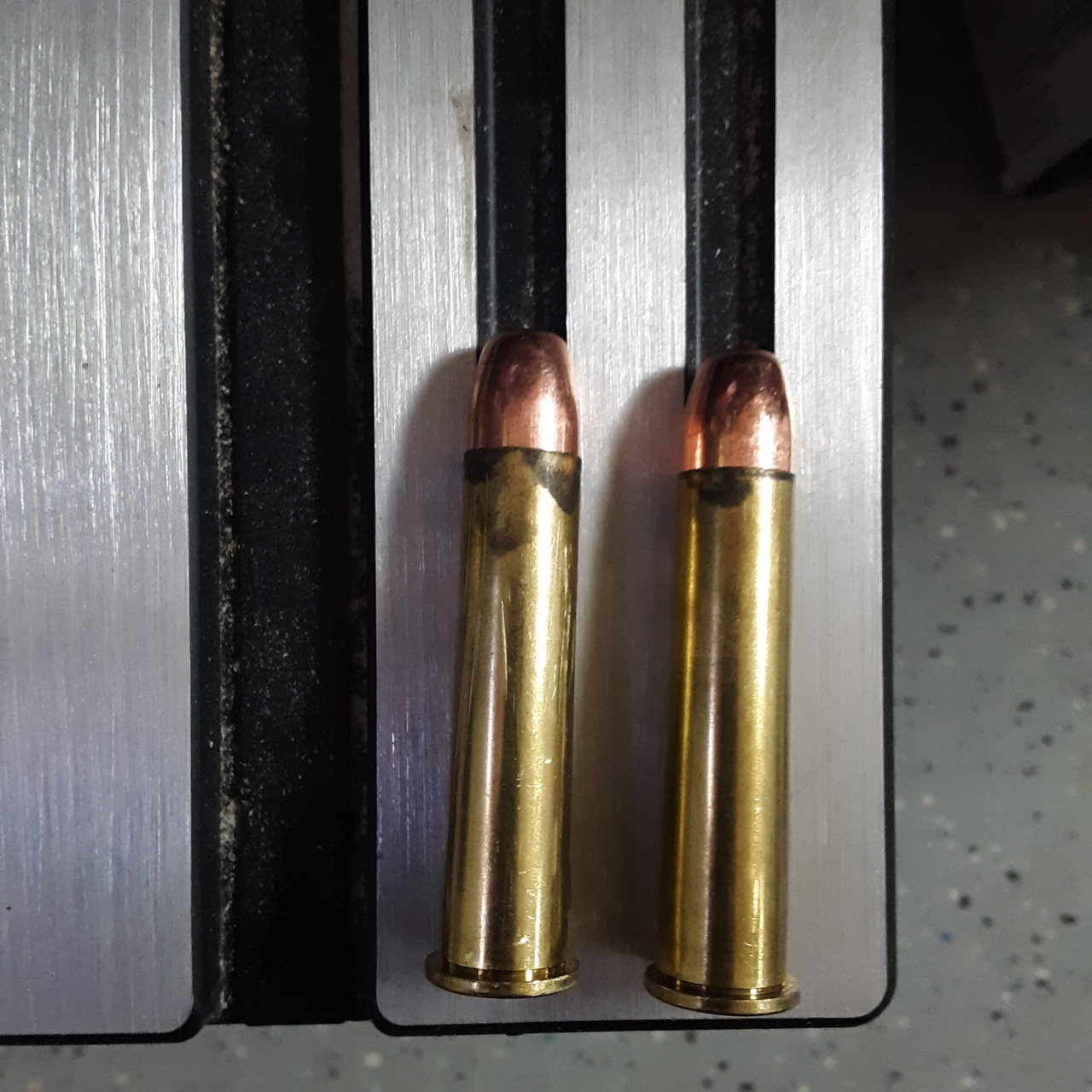

    Did some 45/70.20201230_105409.jpg

    YES !!!! 45-70 !!!
    I love shooting my 45-70’s
    The great thing about loading these is you can load them hot or load them mild for the little ones. They are happy to shoot it and I’m happy to watch them.
    What did you top those with?

    I need to go shoot some, been having a hell of a time getting them reloaded. The bullets pictured i thought might not work, so got some other bullets, which were too long, then got some hard cast bullets that i thought would work so i loaded up 5 and find out they hang up in the barrel!! So found these and will try them. 300gr flat nose will hit hard

    Those Berry's are cast lead correct? Cast lead bullets are always sized slightly bigger than jacketed bullets. You can generally use load data for same weight jacketed bullets, but as always start low and work up looking for signs of excess pressure.
