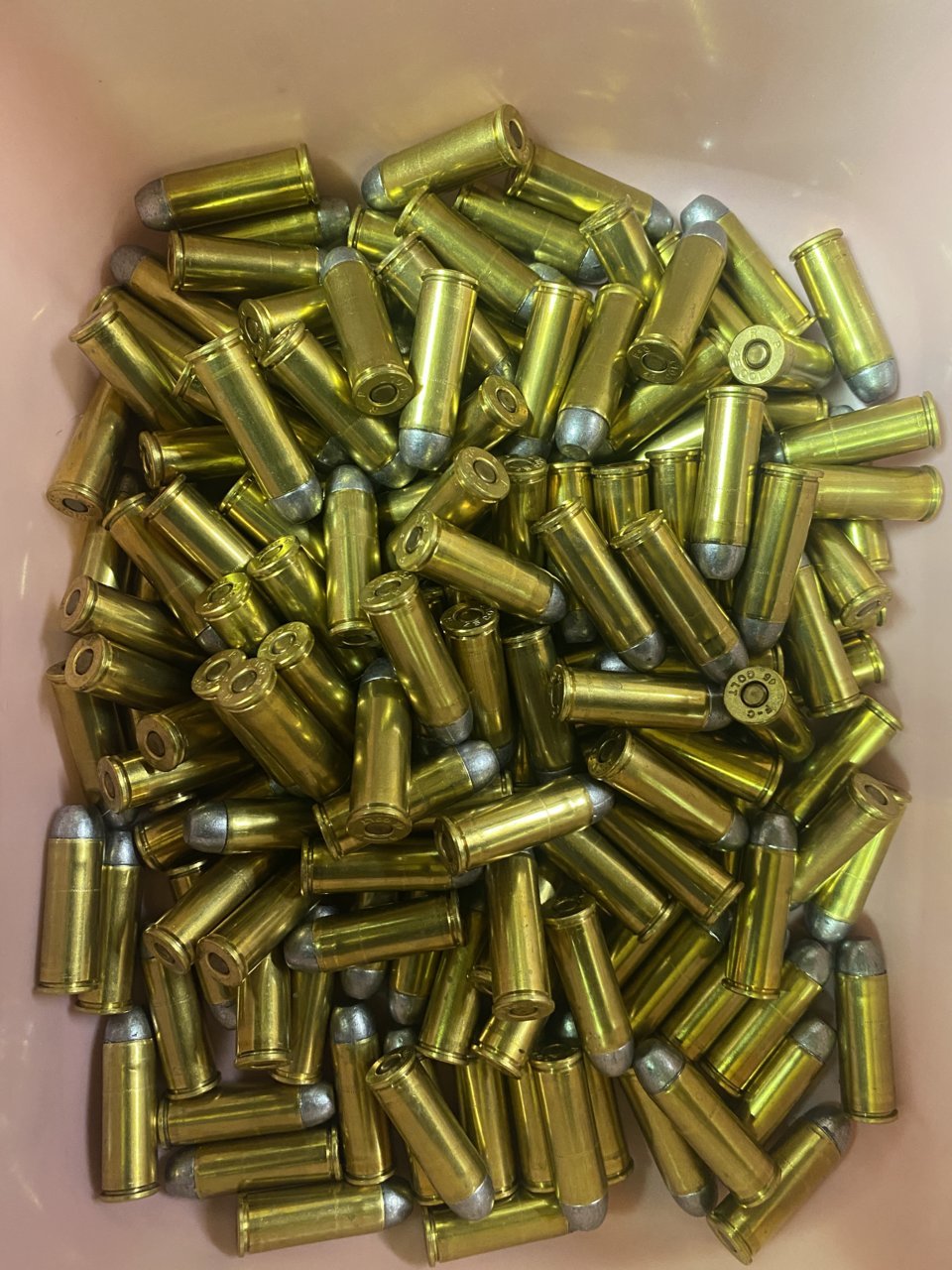

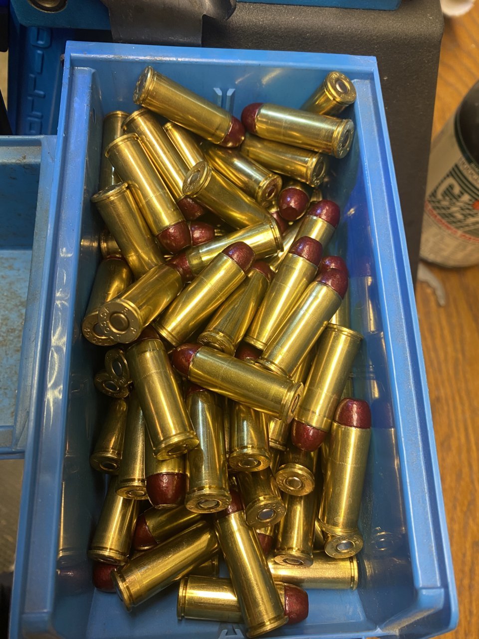

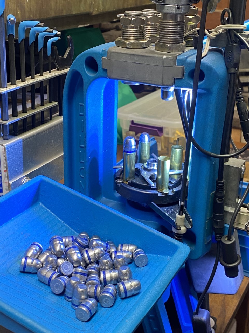

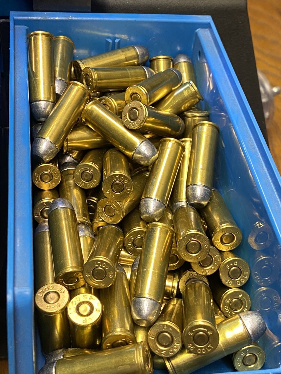

    I was able to find a little time and load up some 45LC.
    250 with 200 gn lead and another 250 with 250 gn lead.

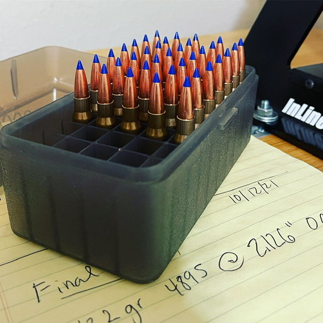

    Drew a big game combo in Montana this year, and maybe a wolf I see one. These run Sub moa out to 200 with my .308. Wish I could find H4895 or Varget, but IMR 4895 will do, 168 grains running 2640 fps on a 22” barrel.

    Looking good! Wanting a Ruger Blackhawk in 45 LC, it’s just not easy to find the right one.

    I would like one too. Those are a nice firearm. These loads are for the SAA pistols I own. They lots of fun to shoot.
