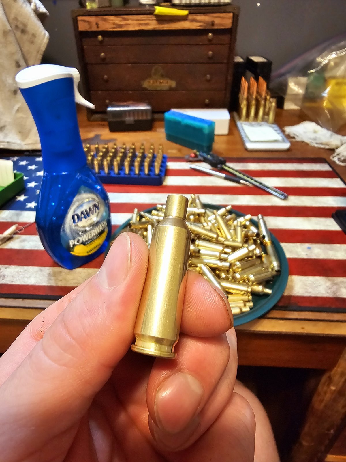

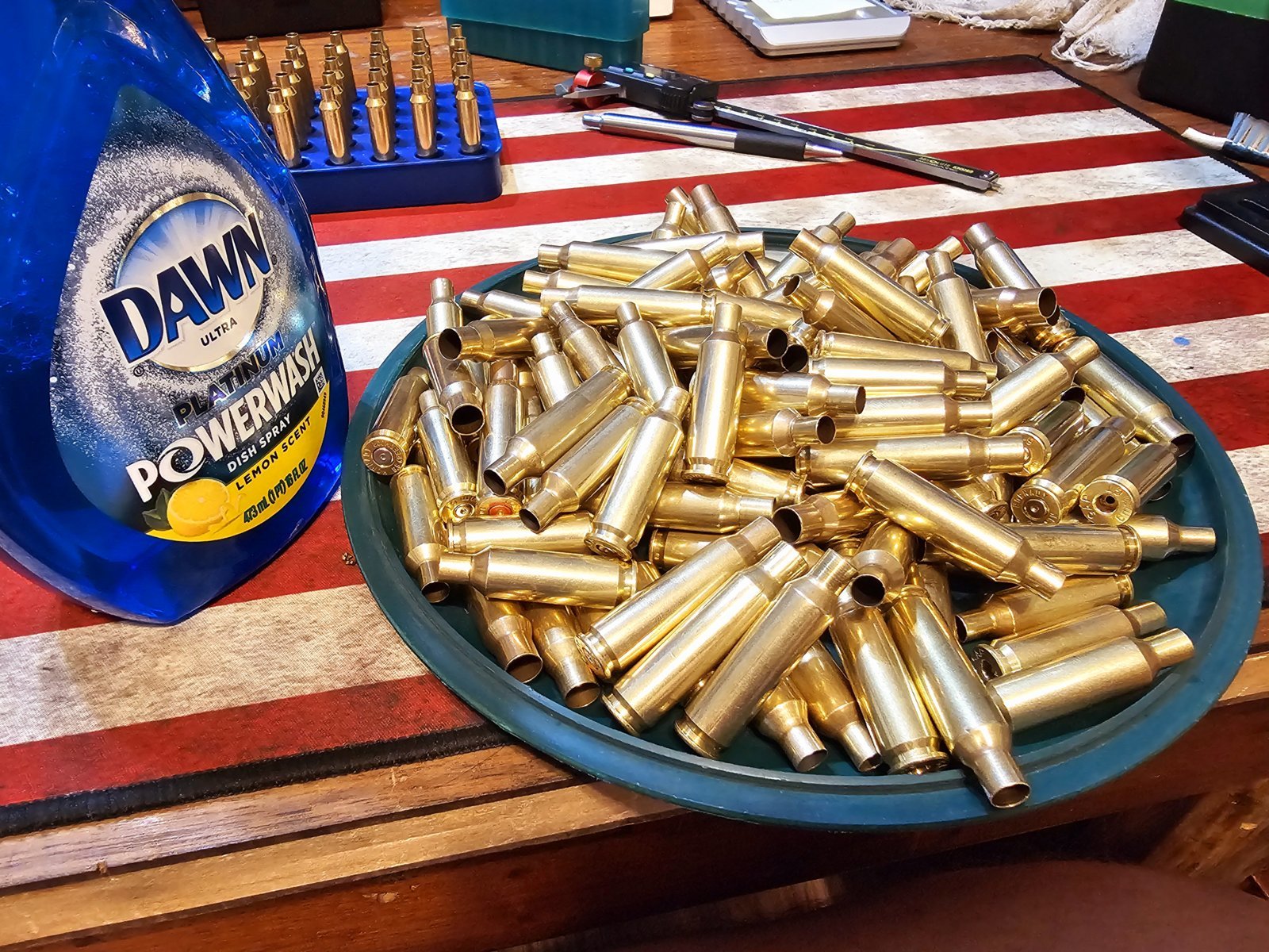

    Thought i would share something I've been doing for a bit now. Dawns powerwash does a great job for cleaning brass. 3-5 sprays in the media and come back 1-2 hours later to these.
    I do have a question for y'all though- when does one know how the media is no longer good? I bet i have 200 hours on the current media in the vibrator.

    When it starts to take a lot longer to get the results you want. Like if you normally do 2 hours in the tumbler and its clean, but then notice its taking 3+ hours to get the same results. Stuff lasts a long time. If you toss in a dryer sheet (i cut one up into 4 strips) itll collect alot of the loose dirt/dust/ect too

    If you use walnut shells, they start to leave the brass dusty when it’s breaking down. It can also leave the brass feeling greasy when it gets loaded up with polish (I use Brasso.) and case lube. I’m overdue for a new batch.
    I want to try the Dawn idea as a polish to see how it works.

    I use crushed walnut, flitz, and cut up dryer sheets. My brass comes out really clean and shiny. The dryer sheets are always filthy dirty, so I'm going to assume it's doing its job of extending the life of the walnut media.

    Either stainless steel pin tumbling with dawn and lemishine or walnut with a cap full of mineral sprits. Compare a handful of old walnut to new. It gets pretty dark.
    Dryer sheets may help keep dust down, but they don't seem to do much else for me.

    Stainless pin wet tumbling is great and gets brass shinier than anything else I have tried but it comes with it's own frustrations. I use an old food dehydrator to dry the brass afterward otherwise it ends up with all kinds of water spots. Also I use a home brew lanolin case lube and with Dawn it wasn't taking it all the way off and just leaving a thinner dirty coat of case lube over everything. I switched to Woolite and they come out clean and shiny as can be now.
