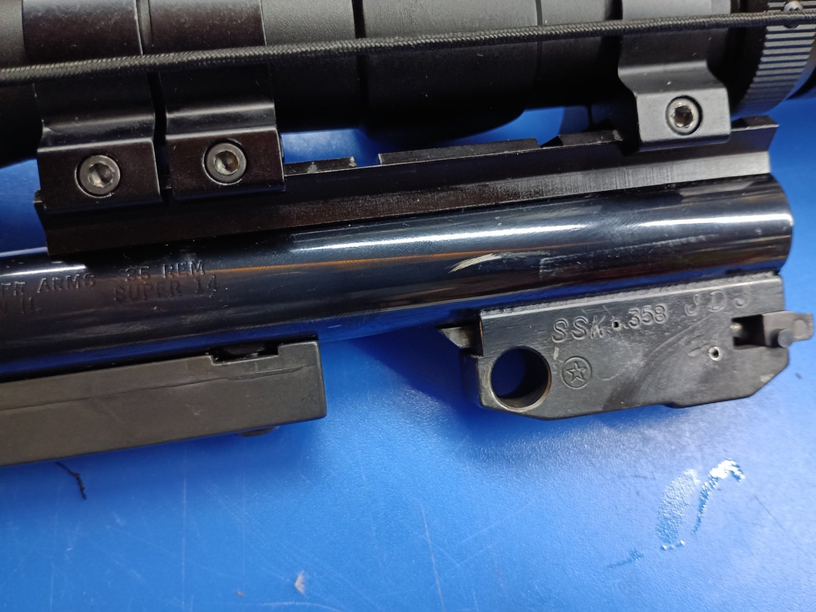

    358 JDJ.
    223 for reference

    That’s a very cool cartridge. I was researching it a little after I saw your posting.
    I should be more adventurous. I’ve been reloading most of my life, but I stick to the basics and tailor my collection accordingly. My Dad reloads for EVERYTHING! Even in his 80s he’s figuring how to reload for his new .577 Snider. lol!

    This appears to be a popular option for a T/C contender pistol. Are you shooting it outta a pistol?

    Indeed. SSK still does the conversion. This one is a 14" 35rem reamed to 444marlin case length which is just necked down slightly to 358. Muzzle is also magna ported. 309JDJ and 375 JDJ are also popular.

    I have a pair of Contender frames. I wish the barrels were cheaper. They’re a lot of fun.
    Great product! I’ve never seen it before.

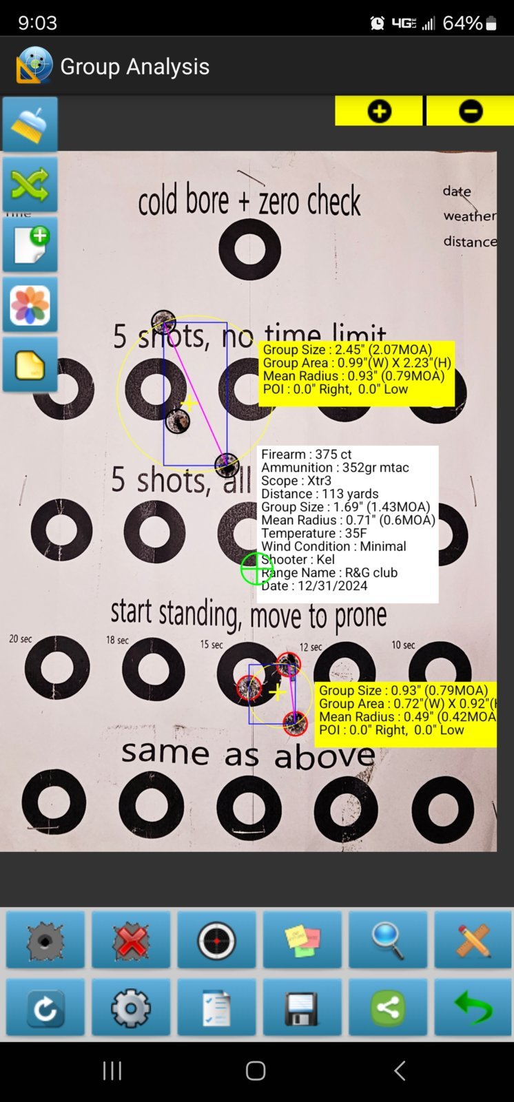

    Trying to get a load dialed in for transonic long range. Finicky stuff. Loaded 127.3grs and 127.5grs of retumbo. Everything else being equal. This is the biggest difference I've ever seen on such a small change.
    It'll shoot half moa with 375gr lasers all day but they don't fly well past a mile due to gyroscopic stability being mehh .
    Maybe I'll wait till i can find the 410gr berger hybrids to continue development.
    127.3 top group.
    127.5 bottom group.
    Approximately 5 kernels of powder difference.

    Possibly adjust your seating depth between the 2 loads?
    Have you loaded 127.2, .4 and .6? Curious what those would do.

    Certainly worth a shot. There isn't much load data available for this round and 127.5 is the hottest I've tried so far. No signs of pressure on the brass but bolt lift is starting to get stiff. Groups were .8moa at 126.0 and 126.5
    I might play more in that range charge wise and play more with seating depth too.
    These are also mag primers. Im gonna try a couple with standard lrp just for the hell of it.

    There's lot of black magic that happens with seating depth...

    Did you chono them?
    Shooting a mile, I'd want ES to be as close to zero as possible.

    Of course i chrono. I would like ES to be single digits but it's just over right now at 10 to 11fps with the 352gr mtac. The 375gr lasers had an es of 4 which was great. But again the gsf isn't high enough on them to do well past transonic flight.

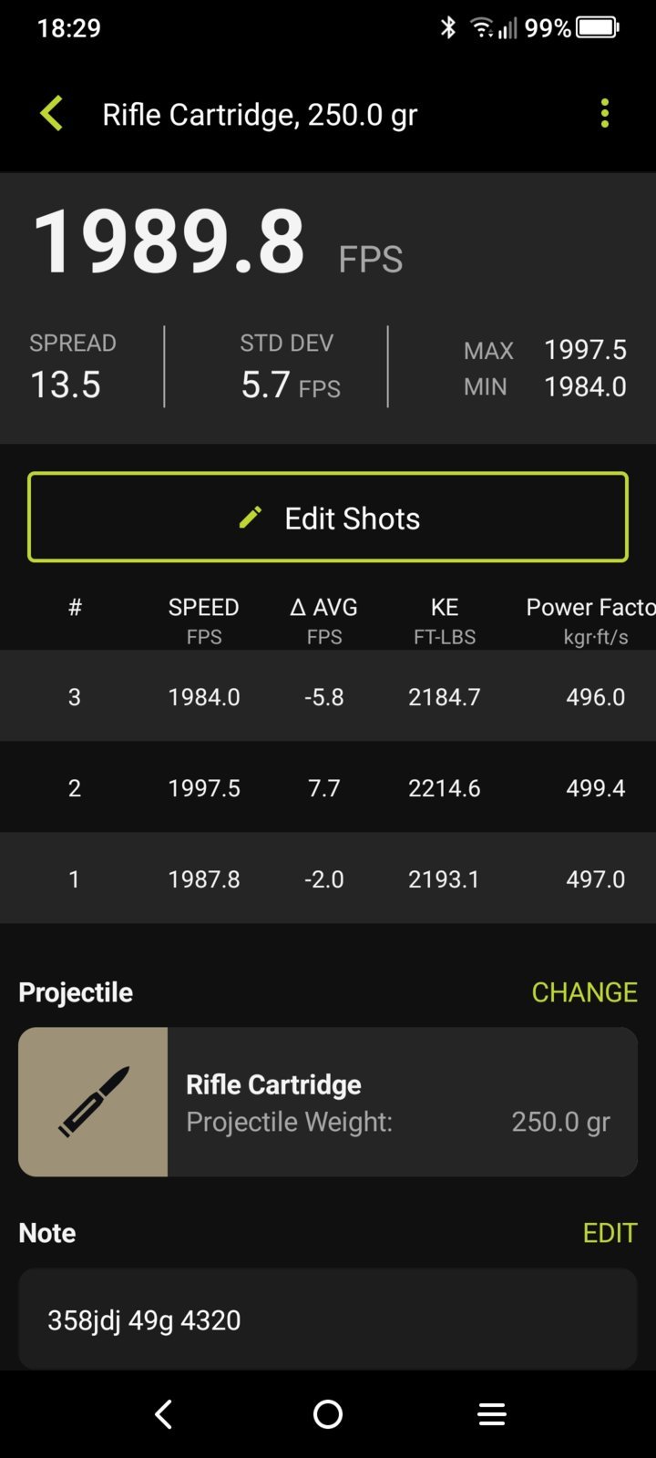

    Here's the verdict. Only 3 rounds per charge weight. Shooting 18 of those was enough.

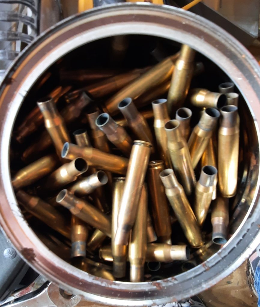

    Anyone interested in some 30-06 brass?

    What you asking for it?

    Always interested. If Velillen passes let me know.
