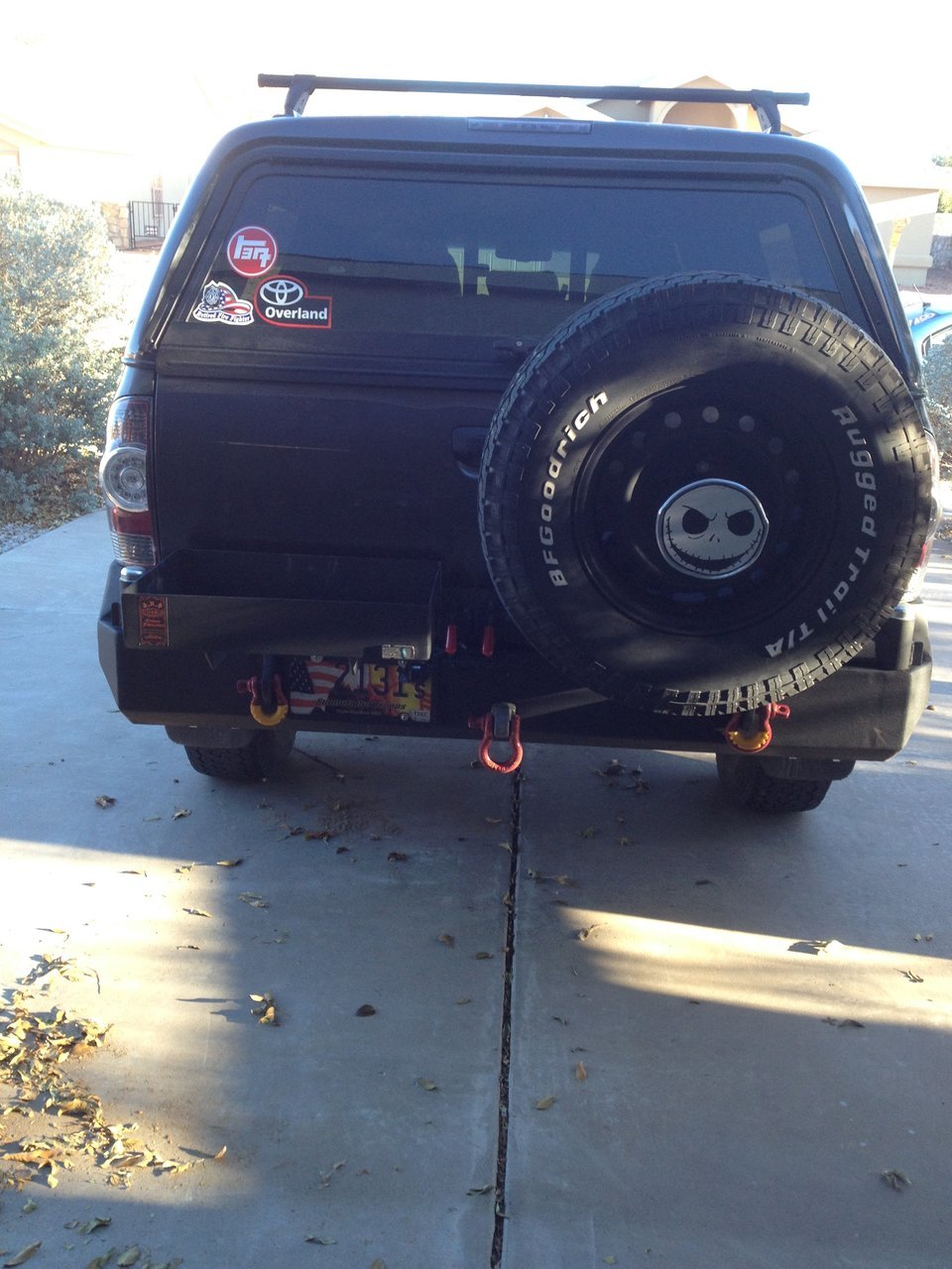

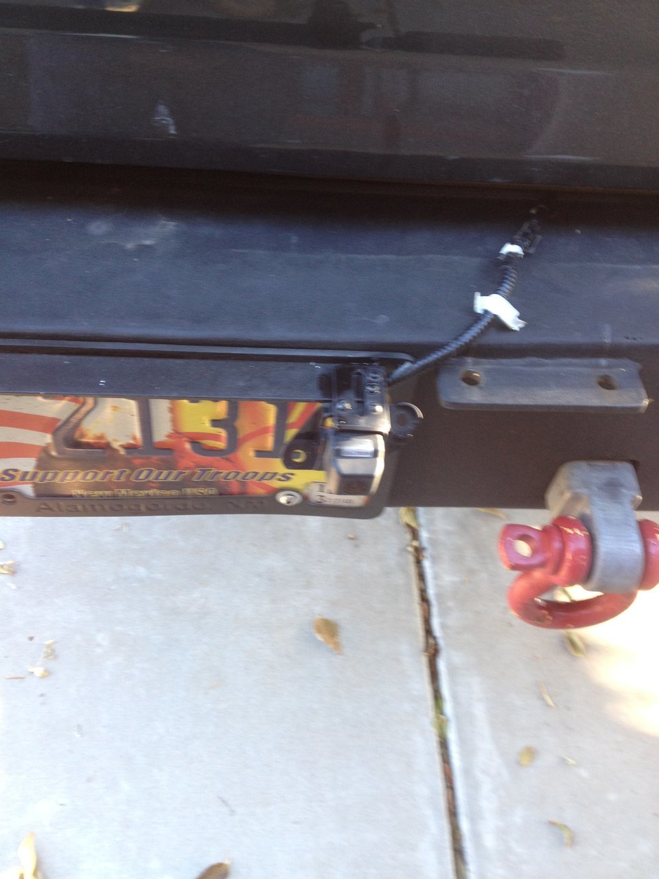

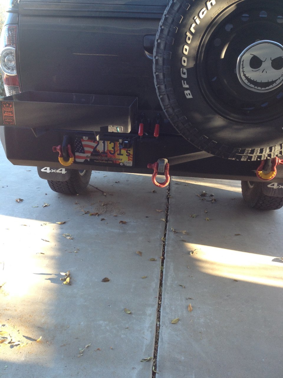

    I pulled the back off the tailgate to get at the camera.
    Un-bolted two 10mm bolts, replaced them back in and un plugged the camera
    Followed the wire inside the tailgate and worked it out through an existing hole.
    Then ran it thru the hole the crank goes thru to lower the spare tire.
    Then doubled the plug back out the hole and over the top of the bumper.
    Let me back up, I needed to relocate it because I have a rear tire carrier bumper and the tire is in the way of the camera.
    I then took a piece of metal trimmed to fit the width of the camera housing and drilled 2 holes in the top and 2 in a piece of angle iron that sits above my license plate . The camera housing sits flush with the angle iron.

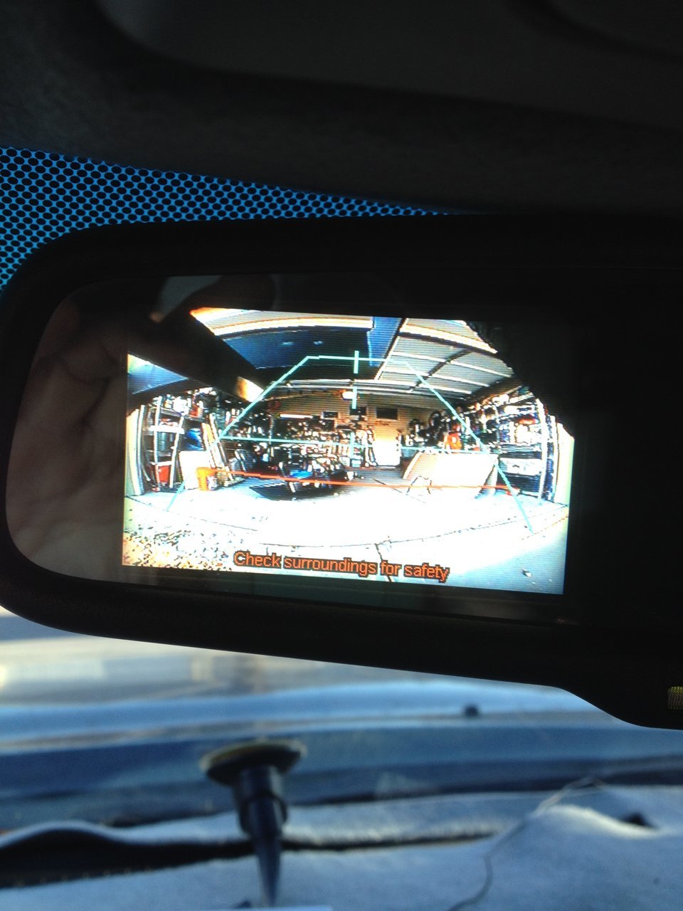

    In the last picture is the new view from the camera.
    I zipped tied the excess wire under the truck.
    Took less then an hour to fab it up.
