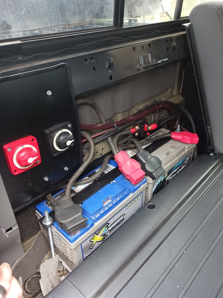

    I am debating on doing this before I tub my truck. I’ve seen many threads about which cables people use, battery boxes, pics of the bed etc. but no one really talks about the engine bay part.
    Anyone have anything to share what they did in the engine bay?

    Reviving this. Need to relocate mine and was wondering what gauge wire people use, and if they run both a power and ground, or just a power and use chassis ground.

    Should do a ground also.
    I used 2/0 gauge. There is just enough room behind the back seat for them if you don’t want to do the bed route
    use welding leads, much easier to deal with. To bad you’re not closer, I have a bunch extra crap from doing mine
