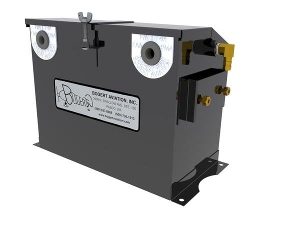

    Exactly. Accepting realities that you may not avoid forever isn't being afraid. I think an AGM is ideal for this and if you plan for the chance that any lead acid battery can vent while charging then you reduce your chance of being the one-in-million guy.
    Every manufacturer says it right in their literature:
    http://www.odysseybattery.com/documents/US-ODY-TM.pdf
    Which just means if there's not a normal turn-over of air you need to make it so the battery can vent to the outside. The inside of aircraft cabins are sealed, as would your truck cab (or camper) if the windows are up.
    This is what they use on aircraft:
