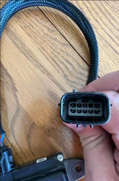

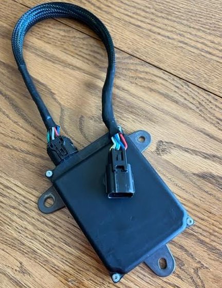

    Hey y'all,
    Just as the title states, I'm working on trying to relocate the BSM to bottom portion of the tail lights. The plan is to get a steel rear in the near future, and I'd like to keep the sensors on if for nothing other than the challenge of doing so. I do like cross traffic when I'm backing up as well tbh. I'm well aware of how finnicky the sensors are, what they will/won't "see" through blah blah blah. First hurdle is getting them connected in a new location.
    SO, to make them work, gotta extend the connectors so they reach the rear of the tail lights. I bought some OEM TSS connectors to make some pigtails, here's a couple shots, they fit perfectly and I matched the terminals up with each side (which have different amounts of terminals/terminal locations) but it's giving me nothing when I power it up.
    Troubleshooting:
    Used 20ga wiring and tin connections, crimped and triple checked correct slot locations.
    Powered up as expected with sensors connected to stock harness, no issues.
    Tried to power up with just drivers' extension installed, did not power up.
    Tried powering up with just passenger extension, did power up, but threw an error.
    If I didn't get the tin terminals installed just right that'd be the next thing to verify I guess, or to just cut the actual connector wires themselves and solder in extensions that way...but that's a bit more committal to the idea than I want to be just yet. I'd love to make sure that it'll work before I take the plunge and jack up my OEM wiring. Anyways, anyone have anything they could add to this? I'd love to crack this cookie.

    I'll check that out, thanks for the tip! I was just checking out a BSM TSB that suggests testing terminal voltage to make sure it's in the right range so I might end up having to do that as well. I don't think wire gauge would affect voltage but could be a possibility.
    For now I think it's verify the terminals are connecting correctly and installed properly.

    Upon further reading, the passenger sensor is a slave to the driver sensor which is the master (hence 9 terminals on the driver vs 7 on passenger). So that's the reason for the error when driver is plugged into the stock harness: the master is working but the harness to the slave is not (I promise that's the actual technical terminology). So it sounds like both the pigtails are just shitty. I'm thinking that it's definitely a user error on my part when assembling the pigtails, they're deceptively difficult to get the terminals installed correctly due to how deep seated they are. Annoying. But luckily Ballenger motorsports, who sells the connecters, also sells them preassembled. So I guess I'll have to have the pros do it and spend a little extra dough. Again.

    Got the extensions to work, turns out I'm just bad at assembling terminals I guess. On to the next step which is mounting and more testing. It's going to be mounted behind a few mm of clear plastic covered in black vinyl (basically just the bottom third of the tail light lens) so I'm pretty confident that it'll be able to send the signal through that.
