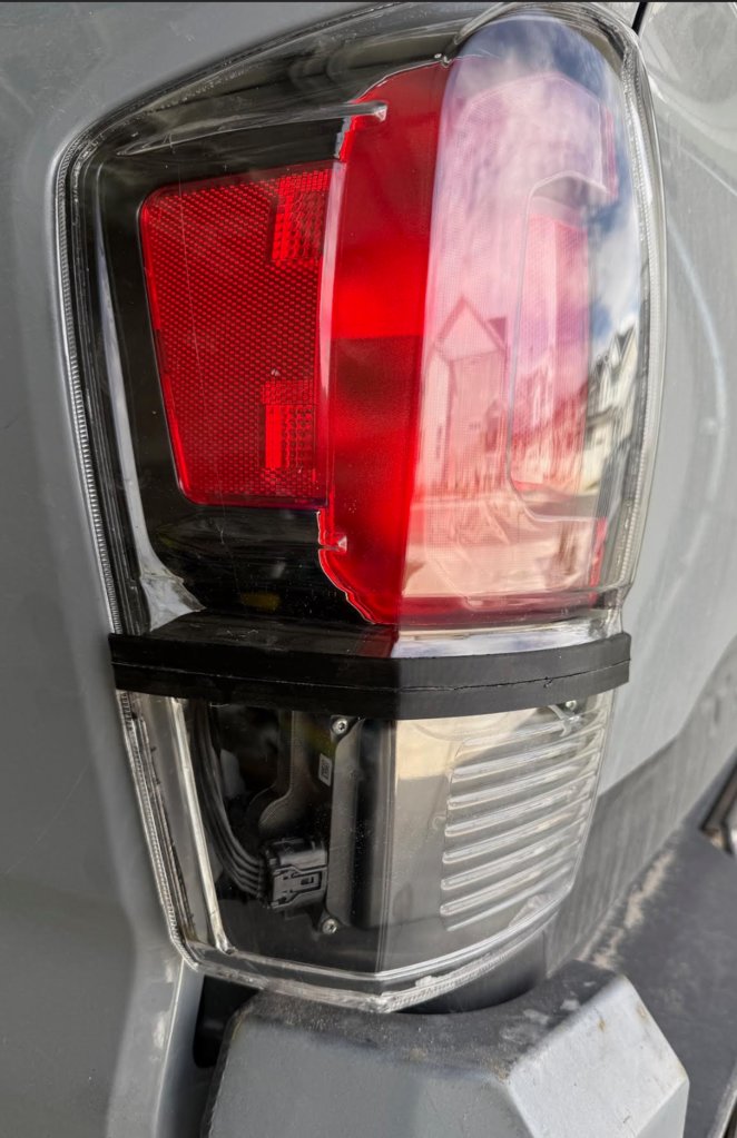

    I had them on the outside first and that worked for 30 mi. When I left work I moved them to the inside and they were working as expected for 15 miles on the highway, and then, for no apparent reason, I got the error. Once there is an error it has to be cleared in techstream I believe. If they will not work tucked in the bumper then I will have to look at moxing them to the taillights if I want to keep them, they will not last mounted to the outside while I am on the trail.

    #102

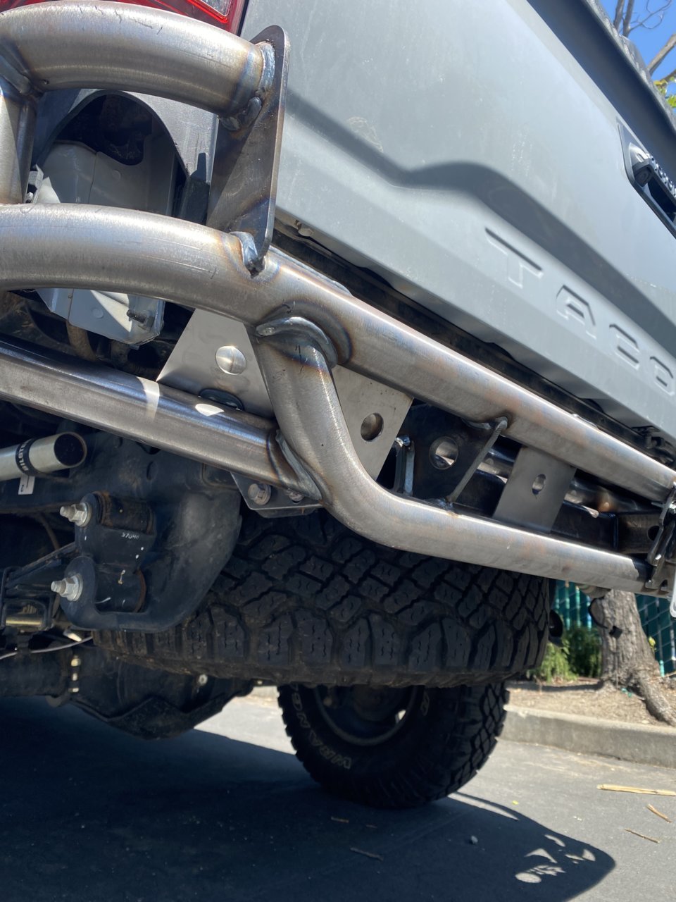

    I welded the plates in for the backup sensors and they worked as normal.
    I am hitting the trails this weekend and then the bumper goes out for powder coat. When I get it back and reinstall I will extend the BSM harness and temporarily mount the BSM on the inside of the tube bumper as pictured above again. I will try to just run it and see if the code resolves itself. If I have no luck then I will use techstream to reset the code and calibration. I do not know exactly the dimension and locating of the radar emitter on the face of the sensor, or the angel of the radar cone.

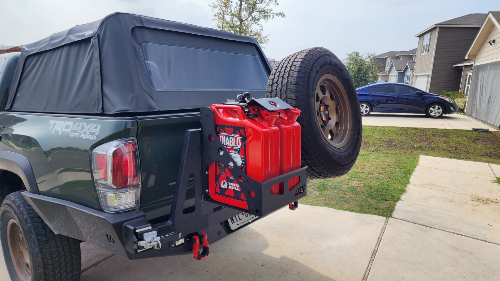

    Awesome work. I bought a Victory Strike rear bumper without even thinking about the BSM. Now there is a solution !!

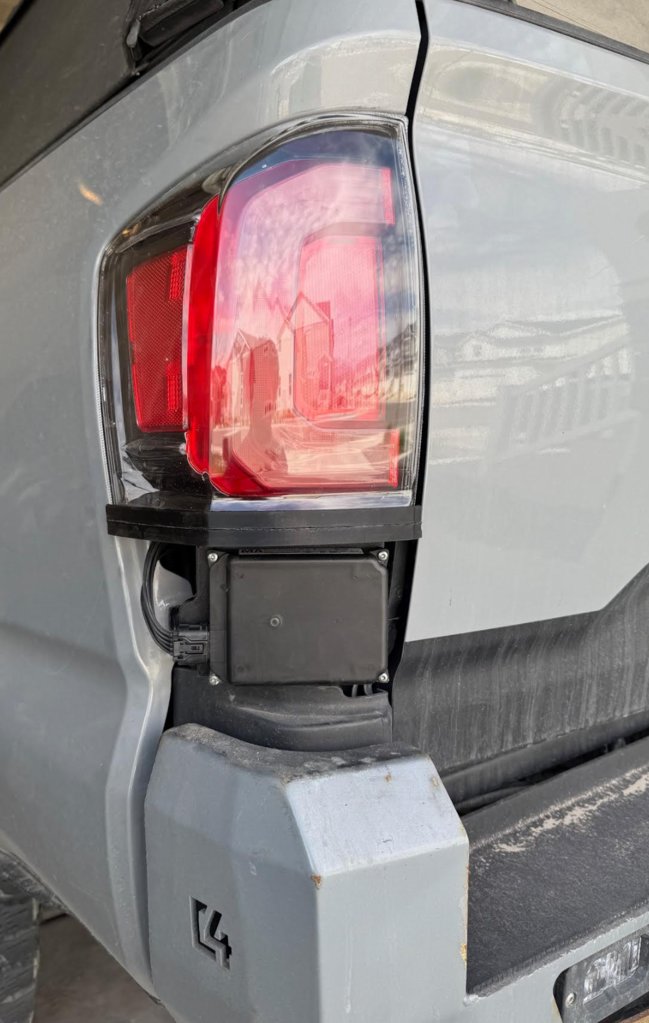

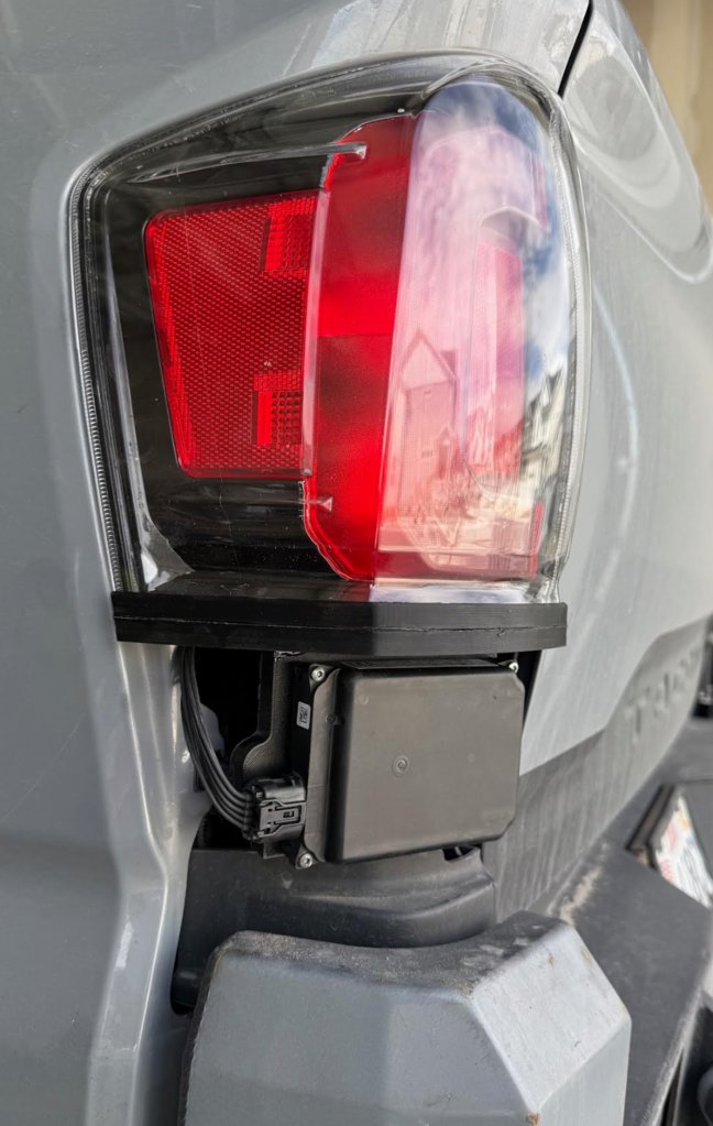

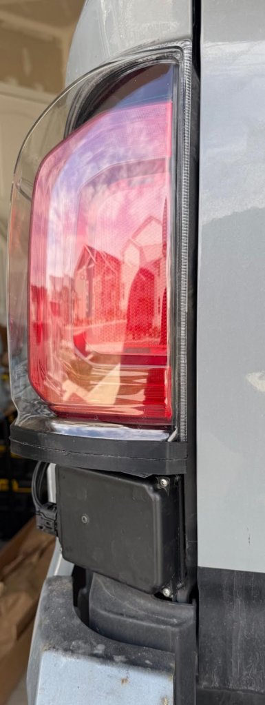

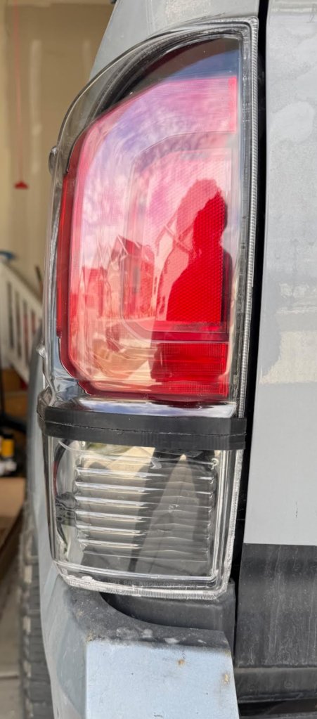

    Hey team, quick update!
    The prototype is coming along nicely. I’m still working through a few final design tweaks—and of course, the biggest question is still ahead:
    Will the BSM actually function consistently in this new location?
    There’s some real testing ahead to figure out:
    • Whether the radar needs re-aiming with Techstream
    • Whether the steel bumper interferes
    • And whether this holds up in real-world use
    So while it’s not 100% there yet, I’m pretty excited with how it’s shaping up!
    I’ll be wrapping up the design soon and looking for a local volunteer or two in the Utah area to help test it—since my own truck’s BSM harness is still on the fritz. (Would be great to get mine working, but hey, one thing at a time.)
    Quick question for y'all—would you prefer this as a DIY kit, where you trim your own tail lights and install the bracket yourself?
    Or would you rather have it offered as a ready-made housing, fully assembled and sealed?
    The cut is simple and quick—the trickiest part is just making sure it’s sealed up tight against water.
    That said, here are some pics of the prototype installed—I’m really happy with how OEM it looks inside the tail light housing:
