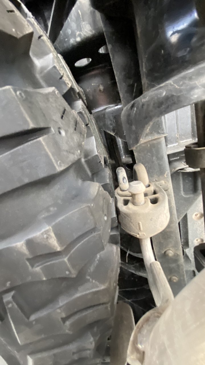

    I was able to fit my skinny 255/85/16 (33.3”) by knocking the tabs and moving the mount forward. It does touch the exhaust mount

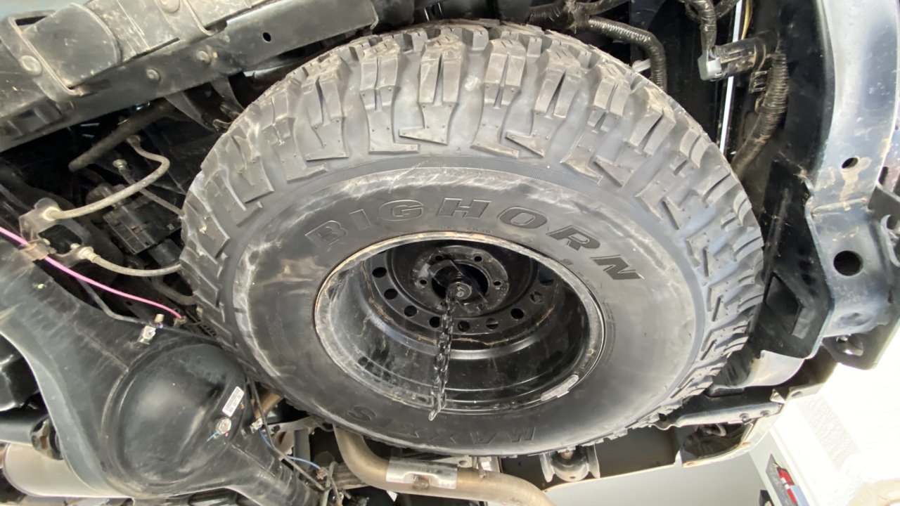

    I was able to fit my 285/75/16 with just bending the brackets out of the way. Glad I did t have to do more.

    I relocated my tire lift and bent the bracket closest to the exhaust pipe (I had my exhaust re-routed for skids and and exahust dump put in so it is out of the way and not hanging low behind the tire) and now my Wildpeak 255/80/R17 fits perfect. The old rubber exhaust hanger even acts as a nice rubber stop to hold it in.
