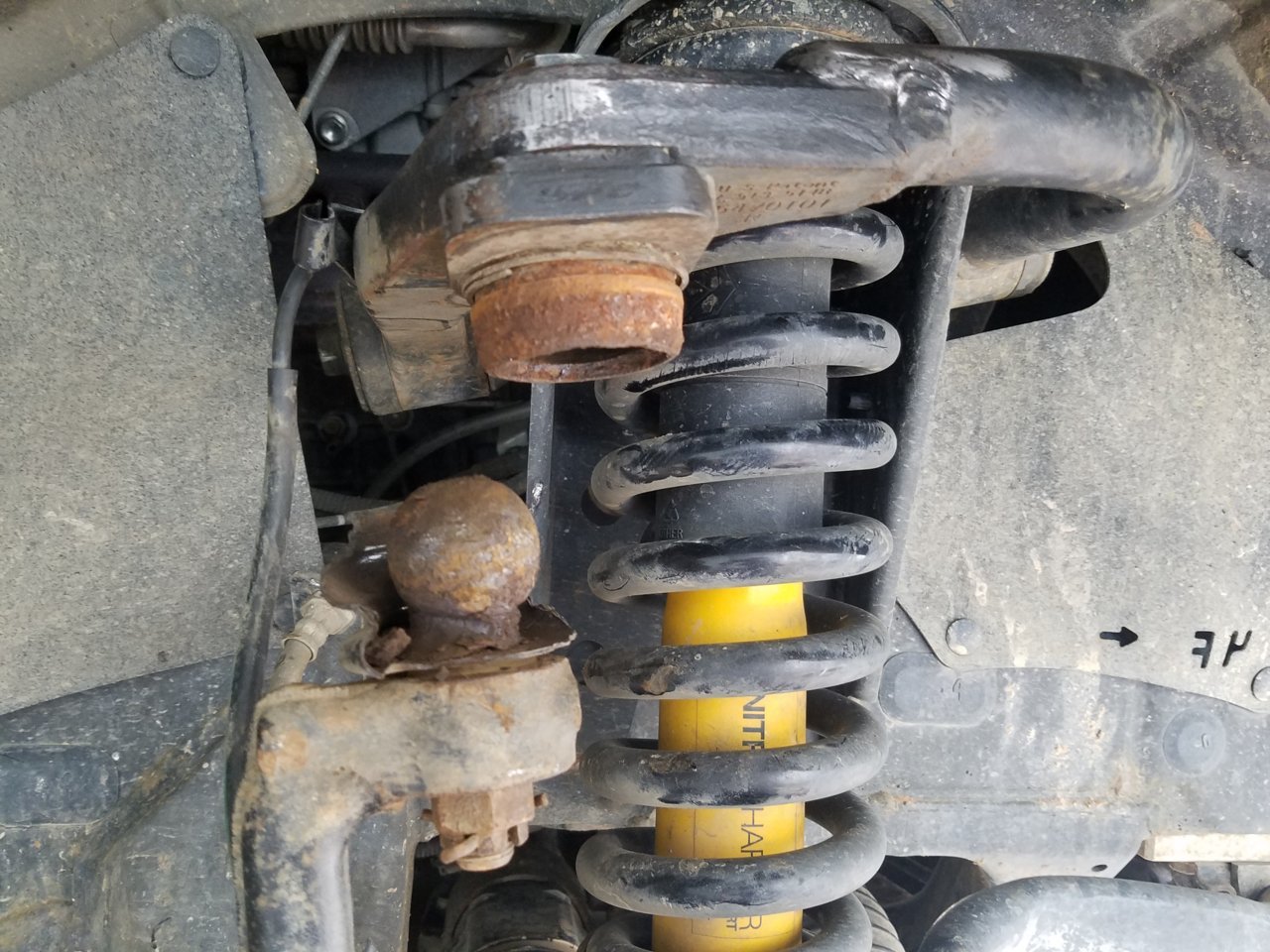

    Good call fellas, just popped the wheel off and looks rusted as hell in there, no grease 20190406_171506.jpg
  18. Apr 6, 2019 at 2:19 PM
    #38
    Pigpen
    Pigpen My truck is never clean
    Mar 6, 2012
    #74319
    9,172
    Dan
    Northwest Montana
    2012 AC Manual 4.0 4x4 Base Model
    Access cab with child seat in the back, yellow wire mod, diff breather relocated to tail light, engine block heater, Leer topper with Yakima tracks and rack, Yakima rack on cab, Ride Rite air bags with Daystar cradles, CBI hidden front hitch, wired for winch front and rear Warn quick connect, Warn x8000i on external carrier, sway bar delete, trailer plug relocated to under bumper, Pelfreybilt IFS and Mid skids, BAMF Tcase skid, ECGS front diff bushing, ARB CKMA12 compressor, 255/85/16 Backcountry MT 3 load E tires on stock steel rims, Toyo M55 tires (same size) on another set of stock steelies, Up2NoGood heated mirror kit, Husky X-act Contour front floor liners, Northstar AGM 24F battery under the hood, Northstar 27F in the cab, Redarc 25 amp DC to DC charger, Pelfreybilt bolt on sliders with kickout and top plates, TRD Pro headlights, Depo smoked tail lights, Energy suspension body mount bushing kit, OME Dakar leaf packs with AAL, OME rear shocks, OME 90021 front shocks with 885 coils, SPC LR UCAs, Up2NoGood 2wd low range mod, 4 Wheel Campers Grandby slide in camper, 4xinnovations high clearance rear bumper, Uniclutch 800 lb/ft clutch
    Nobody likes a rusty BJ :D
  19. Apr 6, 2019 at 2:30 PM
    #39
    brandonbryan12
    brandonbryan12 Active Member
    Jul 29, 2010
    #40960
    40
    Brandon
    Cranbrook, British Columbia
    OME 887x, Light Racing UCA's, Dakar leafs, Fox 2.5 RR rear shocks, Elite Offroad front bumper, Pelfreybilt rear bumper, Famous fabrication sliders, RCI skid plates, OVTuned
    Best to replace the BJ's with the updated greasable version.
    https://www.headstrongoffroad.com/s...ment_Greasable_Ball_Joint_(PAIR)_-_25001.html
    It was also common for the older bushings to bind, I replace mine with the newer version. Couldn't believe how bad the sleeves were bonded to the rubber, had to use threaded 1/2" rod, and big socket to press out the old bushings.
    https://www.headstrongoffroad.com/s...acing_25470/25480_UCA's_-_SpecRide_25476.html
    Good luck with the fix, at least you got her out of the bush safely!!
    SnowroxKT and lynyrd3 like this.
