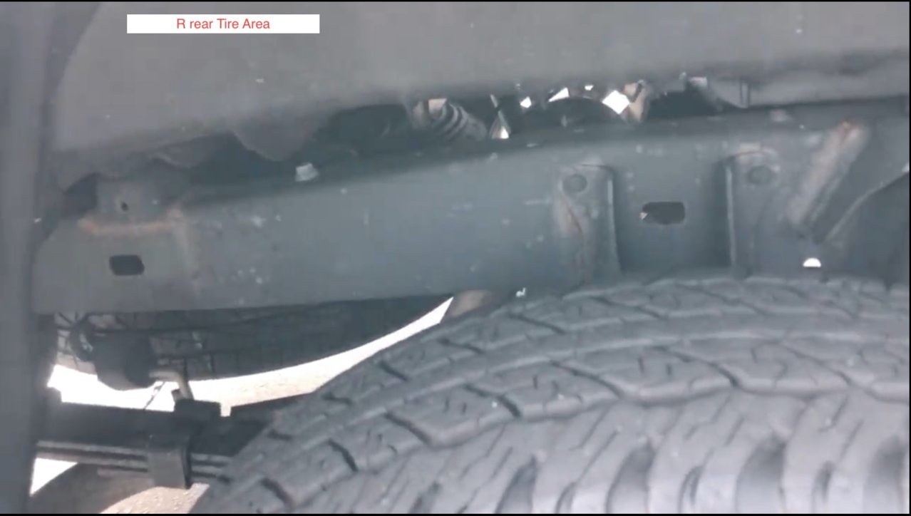

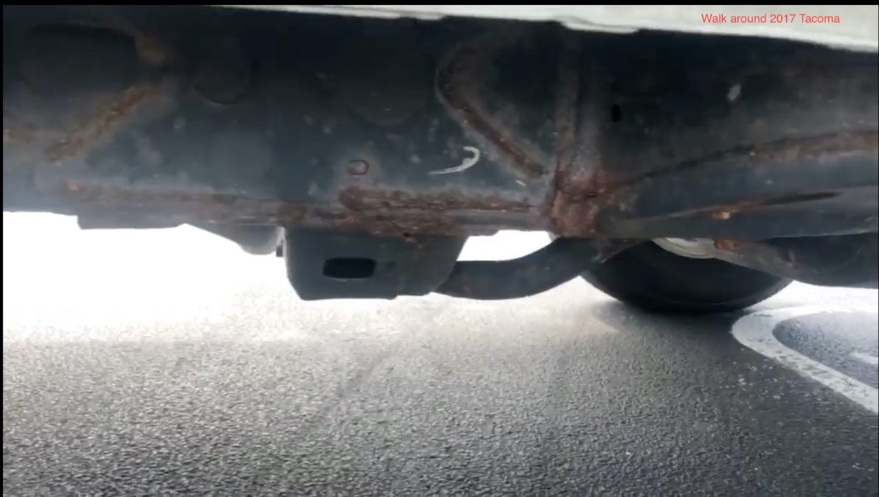

    Hey, guys. I am looking at what mostly seems like a cream puff 2017 Tacoma Access Cab 73" bed. It was a corporate lease held for 2-3 years and has a great carfax and the dealer is selling it as Toyota certified. It did live for 2 years on the coast in South Carolina. They did a video walk around. I saw a couple of things. I suppose I better aske them to do this on a lift so I can see what's underneath. Do this just look like surface stuff to you? That bootm image looks like some water settled inside._Under the rig.jpg_under the Rig 2.jpg

    :eek: That’s surface rust but that last photo of those welds would scare me.
    Like you said it would be nice to see some photos with it on the lift.
    Maha likes this.

    I just emailed these guys--the rig is 2000 miles away--to ask about the Remedy notice, how it would apply. Why can't these guys just look at stuff like that and fix it before trying to pass it on? Without this thread, I would have never known there was a Remedy notice that might apply.
