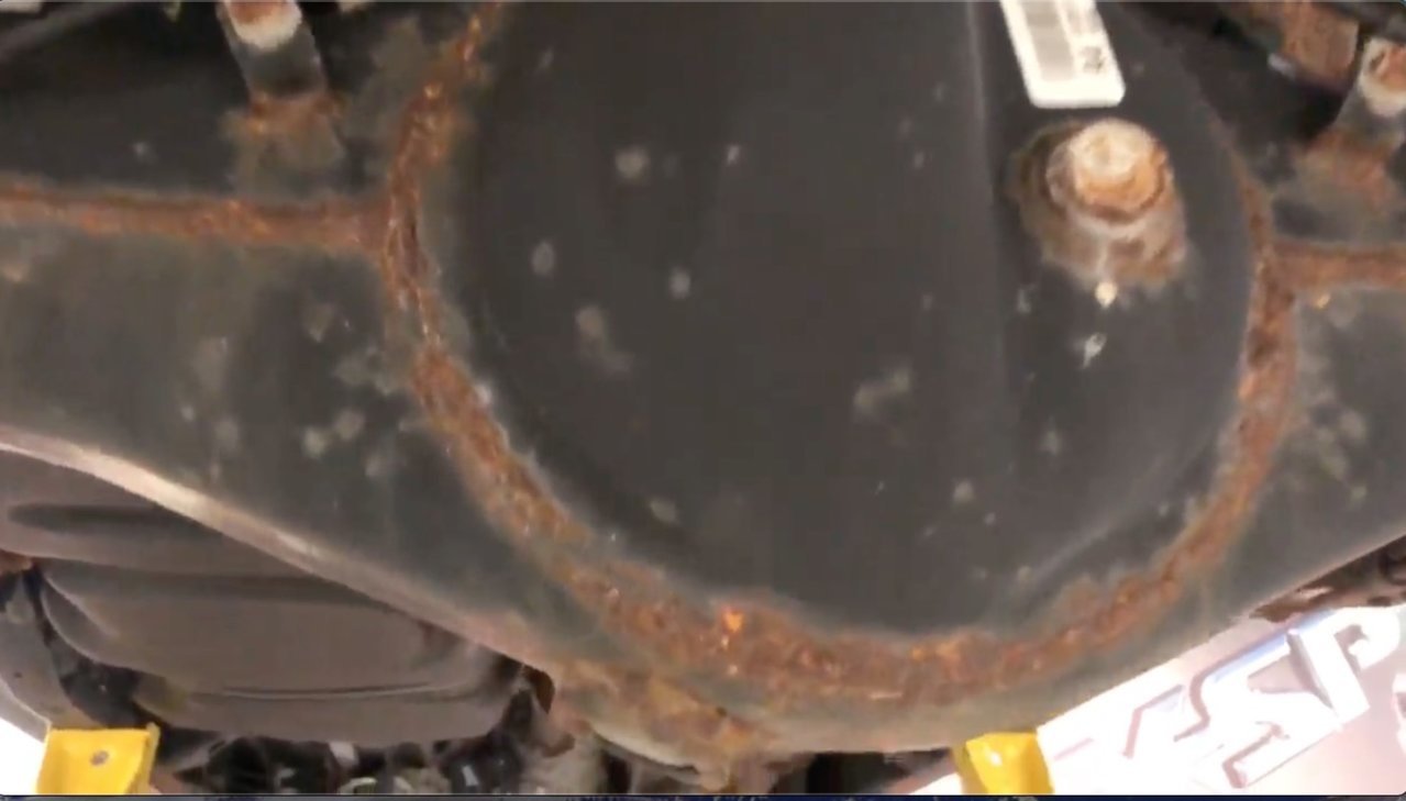

    It seems the rust is along the welds, right? Some moderate surface stuff. The mechanic on the video I just watched--I included two screen shots--said it is all surface. But is it really?Rust on front steering assembly.jpg

    For a 3 year old truck, I think you can find much better condition.

    I appreciate you guys offering advice on this. The more I look at the videos and the images I screen shot, the more it looks like it sat in salt water up to the rockers after a hurricane. This one is a definite no. You'all just saved me a lot of grief.

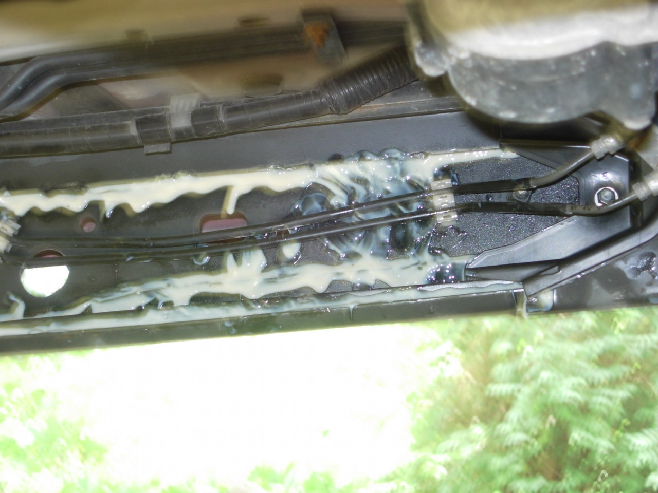

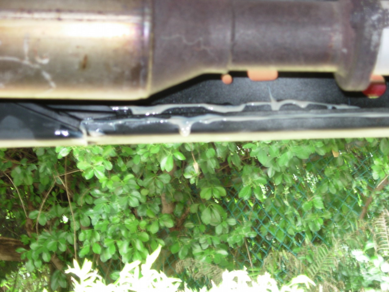

    mine took a week just goo everywhere.

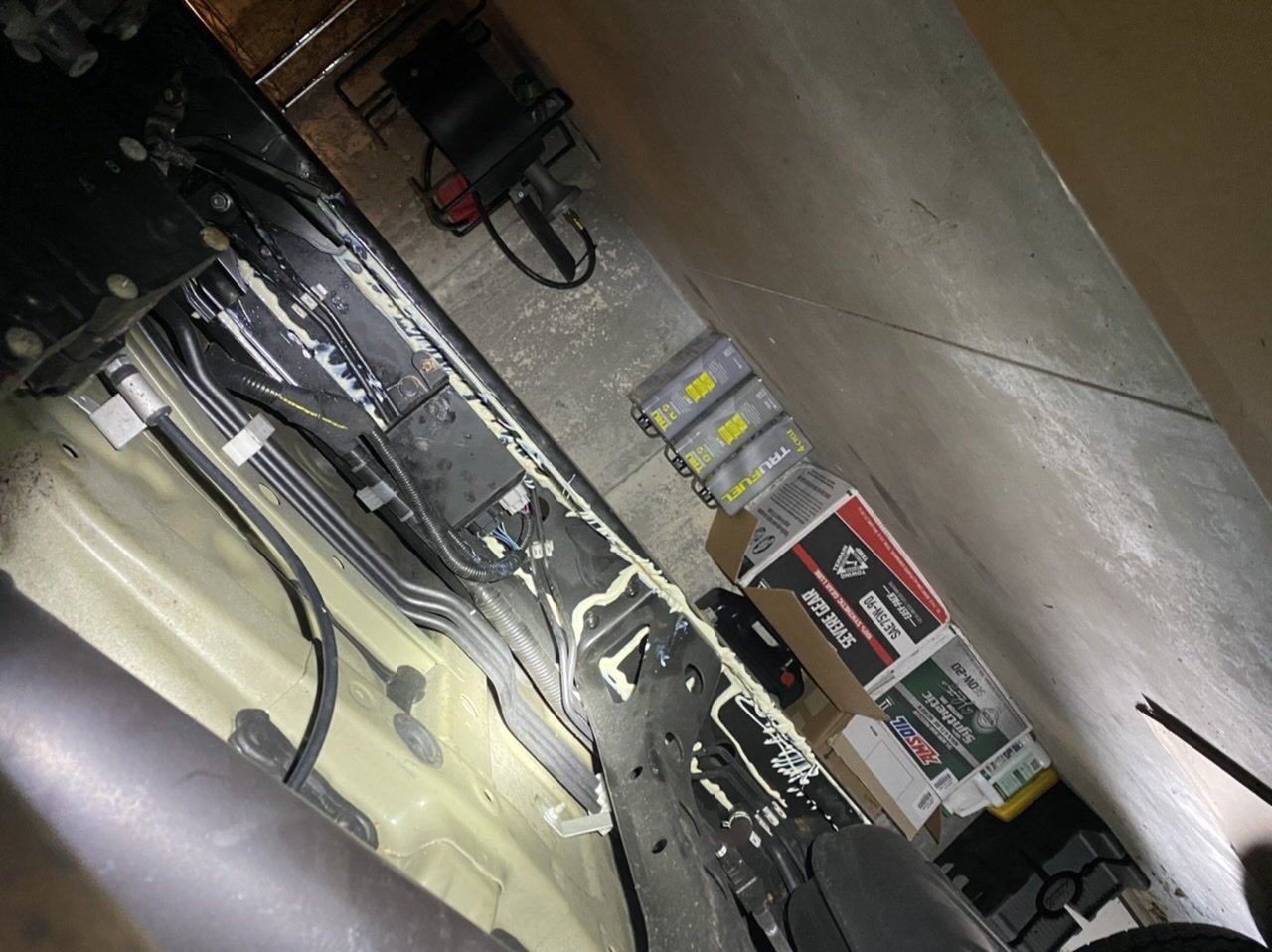

    I just got my 2015 Tacoma back today from having the frame "undercoated with CRC" it doesn't look like they did much of anything. Can someone take a look at my pics and tell me if this is what it's supposed to look like, I can't see where this will protect anything, my 1999 Tacoma rotted out over the rear axle and they didn't even get near that.

    Damn, just created a new thread on this before I saw this one. Just took my 2017 in after getting my letter. Suddenly got a call back saying it was ready a few hours later. They told me the 2017 had the CRC already on the frame but that it did not have the plugs installed in the frame holes. Seems odd mine would have got the notice but not need the CRC.

    Just got mine back after 4 days. Can't really see much, but apparently it's a frame filling process? Based on what I see I will most likely continue to do the oil undercoating each fall to protect all the other frame components. On another note, they gave me a 2020 Taco for a loaner. Basically the cockpit was the same as the '17 with an updated media center. It also has the adaptive cruise control in the SR5 trim, that works pretty cool.

    Just got the work done. The inspection “passed” as there was no “perforations” due to rust. Eg despite visible rust forming everywhere they were not able to put a screwdriver through the frame. An easy out for obvious liability purposes. However, they did squirt mayonnaise around limited parts of the frame, seams and added plugs to certain areas.
    I guess I’ll eat the $200 going forward to have the frame sprayed at NH oil undercoating now that I’ve relocated to the area.
