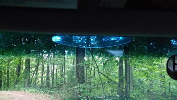

    Have you tried these?
    Light-in-Sight Fresnel Lens until you find another solution.

    Charlotte area, NC
    2014 DCLB sport 4x4
    Real men just call it camping
    Pretty cool idea. Thanks!
