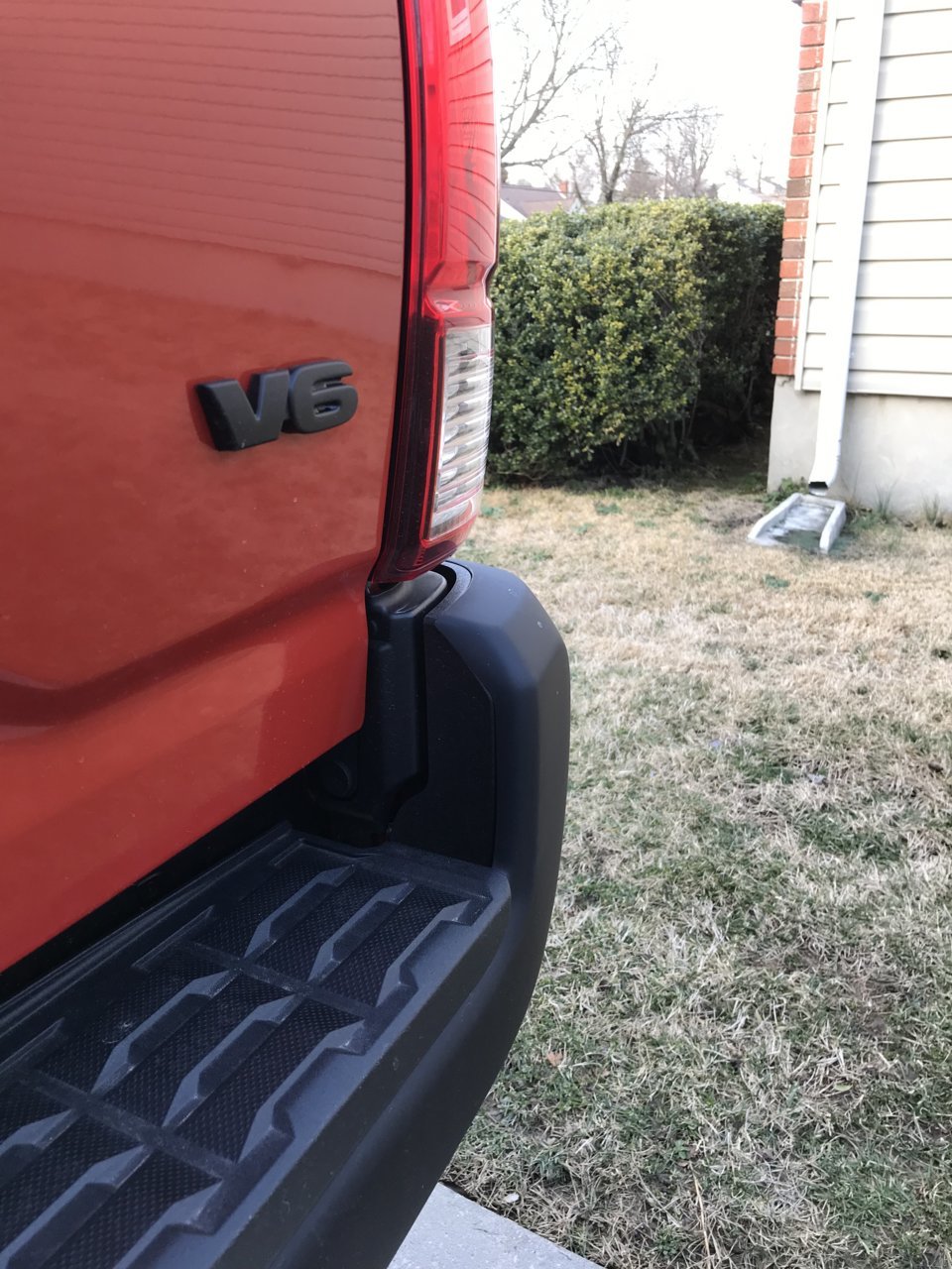

    Can't all this be fixed by loosening a few bolts, aligning, and torquing the bolts back up? Should take all of a few minutes. :confused:

    I have noticed on my 2018 Trd Sport with 5,000 kms that the bed is not aligned properly. The bed sticks out more on one side than the other. Looks like to me that this is a issue coming from the production line. Once the weather warms up I will loosen the bed my self and align it straight. Did anyone else have this problem?

    Maybe it got pushed down putting the shell on . Bolts might not be tight enough .

    Same thing happened to me when i bought my '16. Thought i was crazy for a while at first, then thought it was undisclosed damage....but this is just an adjustment issue (if it bothers you enough). I haven't spent enough time looking at the rear end to do anything about it yet. I was glad to find out it was pretty common.

    Thanks for the advice guys...I will try to adjust it myself when I get a few minutes. I thought it was a more complicated issue than that...

    Common issue, easy fix. Shouldn't even need to contact Corporate for something this minuscule, dealer is just being a butthole. Mine is a bit like this too but not as extreme as yours. I'll adjust mine whenever I have some free time.

    Loosen the bracket,lift it with a jack,align, and retighten the bolts,simple.
