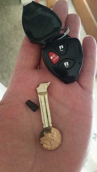

    I bought one of the all in one keys late 2014, didn't make it 2 years.
    Put it in he ignition one day and turned the key and it completely fell apart. Apparently the glue that they use to bond the key to the back plastic gave way. Luckily I had my spare key in a hitch safe and didn't get stranded.
    Still trying to figure out what epoxy to try for the fix. Nothing broke, just glue failure, so if I can find something that a thin coat can bond plastic and metal strong enough for the rotational forces I may try to fix it. Doubt I will buy another of the same type.

    FWIW The flip key uses a pinned connection to hold it in the fob. They actually had to remove the key via the pin in order to cut it.

    Here is what it was, same key as OP posted a pic of. Penny is just covering key cut lol, others posting about people cloning keys from pictures made me paranoid lmao

    There isn't a lot of surface area on the key to get a good bond.thinking about drilling a few small holes in the end and getting a bit more for an epoxy to hold to.

    I'd call the Toyota dealer and ask how much the 16+ Taco key is, also check the Yaris key as they look the same.
    Looks like part of the metal key broke as well, or is it supposed to be unsymmetrical?

    Yeah, that's the way the key is shaped.

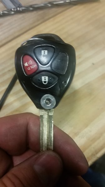

    Third option I have is drill and tap the key then put a couple set screws in and maybe a bit of epoxy. I won't buy another one like this, but if I can fix this one I will. It works fine, just don't trust the longevity of it.
    Found an M2.5 × .45 tap here at work but don't have any screws on hand. Going to see if I can get it tapped today and stop by radio shack or something to find a couple screws.

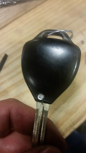

    It's a bit crude and the screws I ordered are a bit bigger than I wanted, but it's actually pretty freaking stout as is. The plastic cracked a bit as I didn't have the oversized drill for the thread relief.
    Hoping a thin layer of epoxy/superglue will bond it back together.
    I feel cheap now lol
