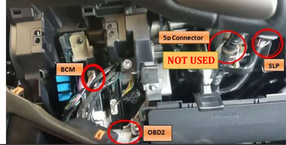

    Where is the 7 pin SLP connection for the 12V solutions plug and play??? Trying to install now and I don't see the 7 pin anywhere...My 2016 Tacoma doesn't look like the one in the video and this is frustrating!!
  19. Sep 9, 2017 at 1:23 PM
    #19
    kcfan76
    kcfan76 New Member
    Aug 16, 2017
    #226957
    4
    James
    2017 Silver Tacoma TRD Off Road
    This should point you in the right direction.
