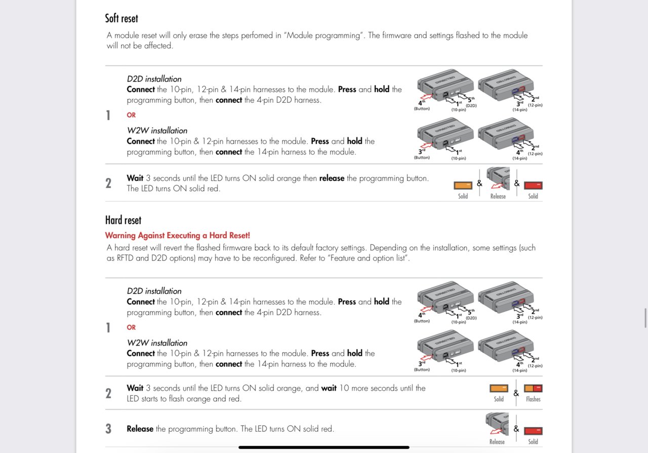

    I did a master reset and it did not help. I had the battery disconnected several times without any problems before. Talked to directech about a year ago and they just suggested taking it to an authorized dealer. I called around for one since the original dealer who installed it no longer carries my remote start. The price given to look at it made me think to try and find a free fix or buy a plug and play system like I put on my Tundra.

    If you did a hard reset, then it cleared the firmware and the brain needs to be re-flashed by a Viper dealer.
    If you did a soft reset, it just needs to be re-programmed with the mobilizer data

    I did the soft reset so I didn't want to erase anything.

    Perform a soft reset again, then the LED should be solid red.
    Put the key in and turn to ‘on’ (but don’t actually crank)
    Wait for the LED to turn solid green for 3 seconds then shut off.
    Remove key
    now shut the doors and try the remote start
