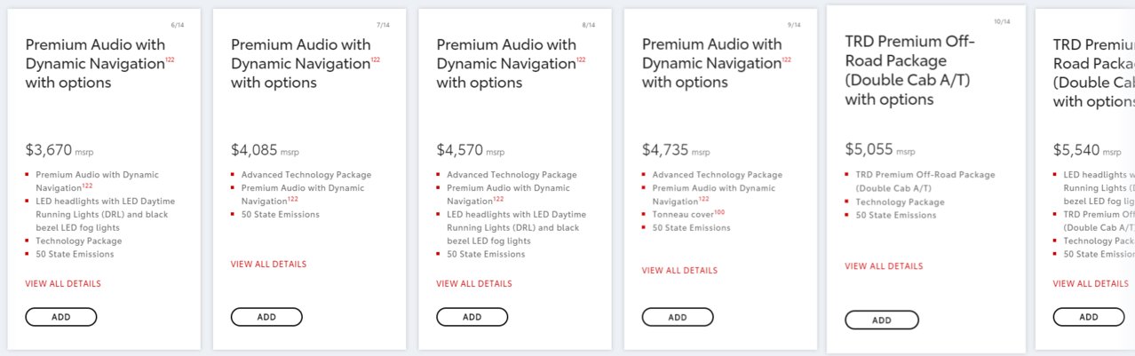

  15. Mar 6, 2020 at 12:29 PM
    N2DesignsInc
    N2DesignsInc --------------------------- N2 Designs, Inc. Vendor
    Jan 26, 2018
    #242487
    2,358
    Los Angeles, CA
    2018 that identifies itself as a 2021
    Mods: Is this still a Tacoma?
    You need the mid level premium package to get remote connect unless the option is called out independently. It starts at the $3,670 Premium Audio with Dynamic Navigation with options package and on to be automatically included.
