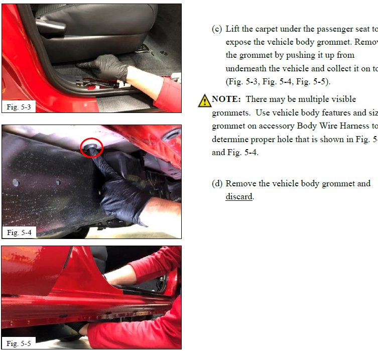

    Does anyone know if the OEM Tailgate Lock fits the SR 2.7 ACLB? I have been having trouble looking for confirmation on forums.
    I did read something about checking the plug under the passenger seat?
    any feedback would be appreciated.

    I believe the plug you need to worry about is in the passenger foot well, in front of the door. Thats where it actually plugs into the vehicle. The only thing inder the seat is the rubber plug where the harness enters the vehicle.

    I agree with this advise. OP, watch a few vids and see if you have the plug behind the passenger side kick panel.

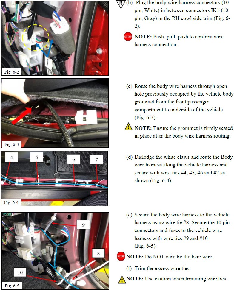

    Looking over the OEM instructions it says to disconnect the negative battery terminal and that you should use 3M Body Sealer on the single clip in the tailgate.
    For those who have done the OEM install did you disconnect the battery? Is there really a need given the connections are just plugged in? Also that body sealer is expensive for just one dab. Did you guys use it?

    I did the install and didn’t disconnect the battery, I didn’t really see the need to with the truck off. I understand why Toyota recommends it just to be overly cautious. For the clip, I just used some silicone gasket maker I had lying around underneath that clip when I put it on.

    I did not use the body sealer. I had some scrap PPF lying around so I put that between the clip and the tailgate frame.
