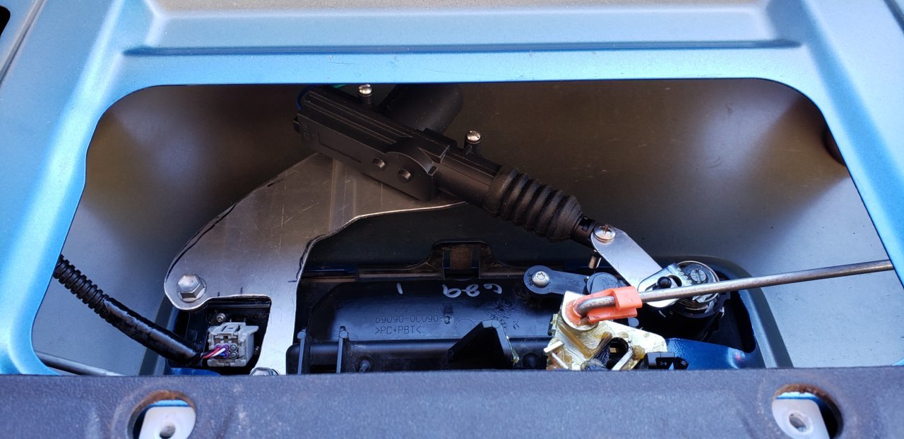

    do you have the plan or diagram for the template you used?

    I just removed the handle assembly to use it as a template to bolt it up and then free formed the rest until I was happy that the solenoid didn't over throw one way or the other.
