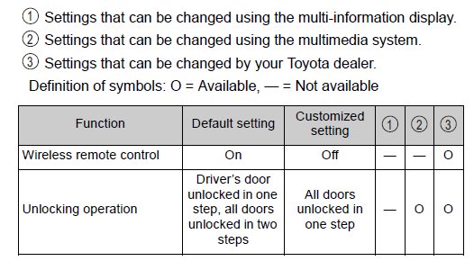

    Mine unlocks the passenger doors and tailgate after the button is pressed twice by default. I think the kit only plugs into one location on the passenger side footwell and the lock settings are adjusted with the doors through the head unit or via techstream. It's under warranty, so have the dealer change the settings if needed.

    That setting is in the head unit. Just change it, like shown in @caribe makaira 's post above.
