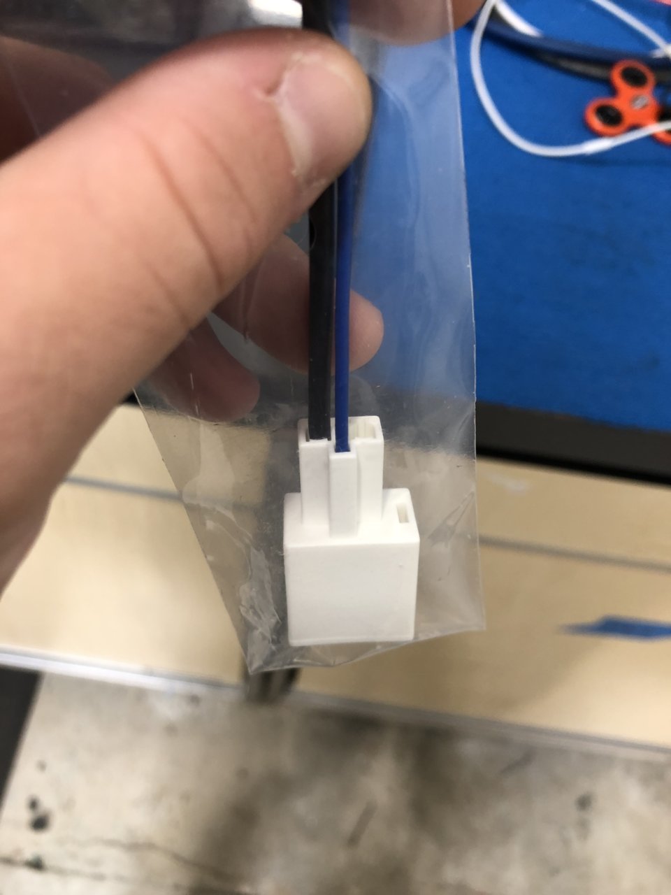

    We are looking for the connector that plugs in here.
    Then, we want the smaller wire in that connector. That is the power for the factory antenna, and is only hot when the radio is on.
    In this pic, it is blue, but in the truck is will be black)

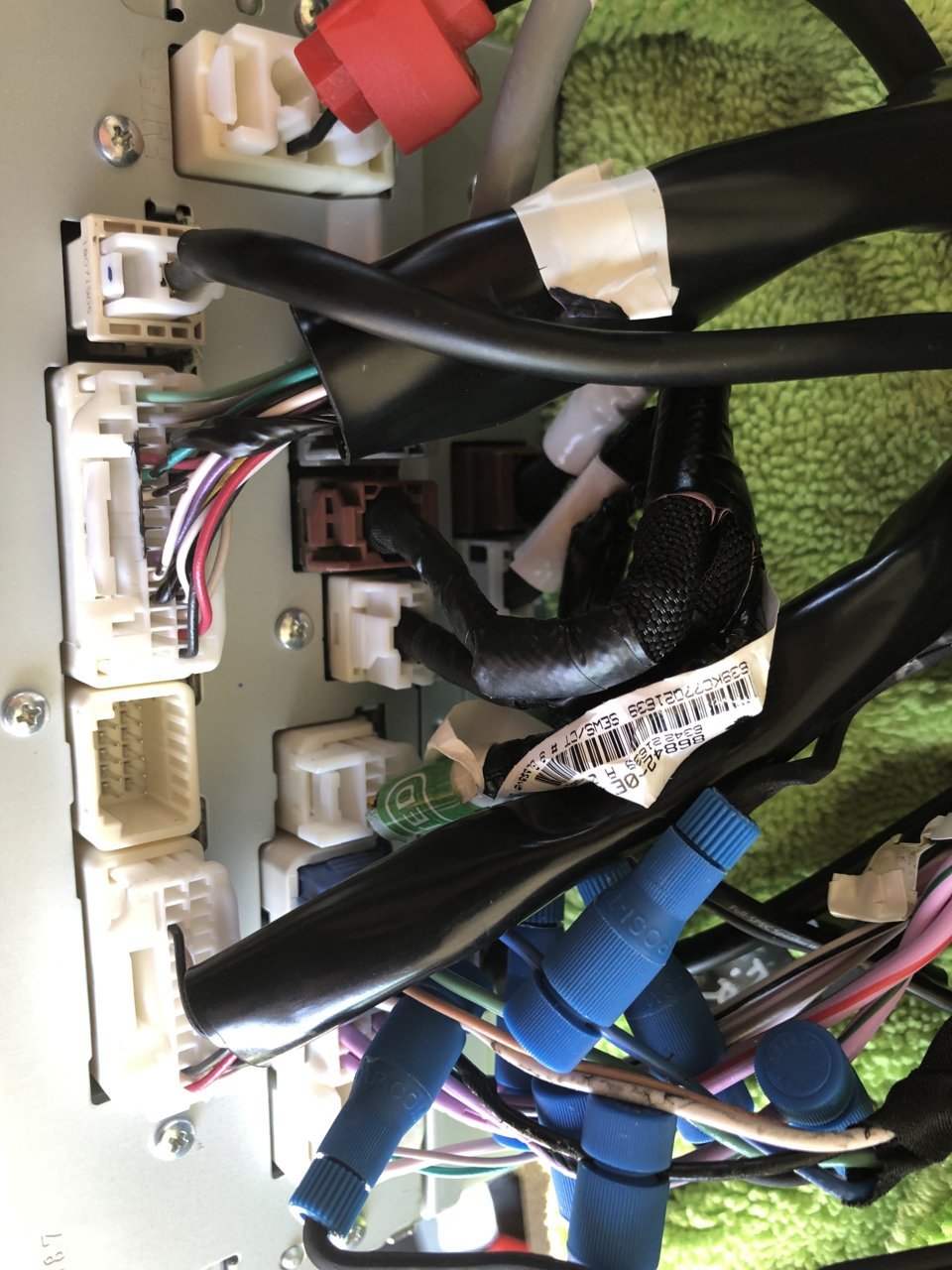

    will do, ran into a bit of issue but just hoping is a loose wire from I attached to the speaker wire for the Rear RCA..some reason no signal was getting to the amp.
    extremely tight fit to squeeze those Posi products Tap-its in one area.
    may pull the head unit out and spread it a little bit..having 8 of those right at the plug is extremely a tight fit.

    Destin, I’m sorry man. Is there a plug that goes in the empty spot in the image? A buddy helped take the plugs out of the stereo and isn’t here anymore. I can’t find an extra plug??
  16. Aug 9, 2019 at 6:05 PM
    #16
    destin_meeks
    destin_meeks I used to fix people's crappy stereos
    Jul 14, 2017
    #223997
    3,934
    Destin
    Tuscaloosa, AL
    2017 SSM DoubleCab TRD Off-Road 4x4
    Unfortunately, off the top of my head I’m not sure what goes there, or if it’s even used at all. It might be a connector used in the JBL system? Worst case scenario, you notice something doesn’t seem to work and that answers your question. If you can’t find a plug, I won’t promise it’s hidden somewhere. But I also know I’ve “lost” lots of plugs in my time installing.
