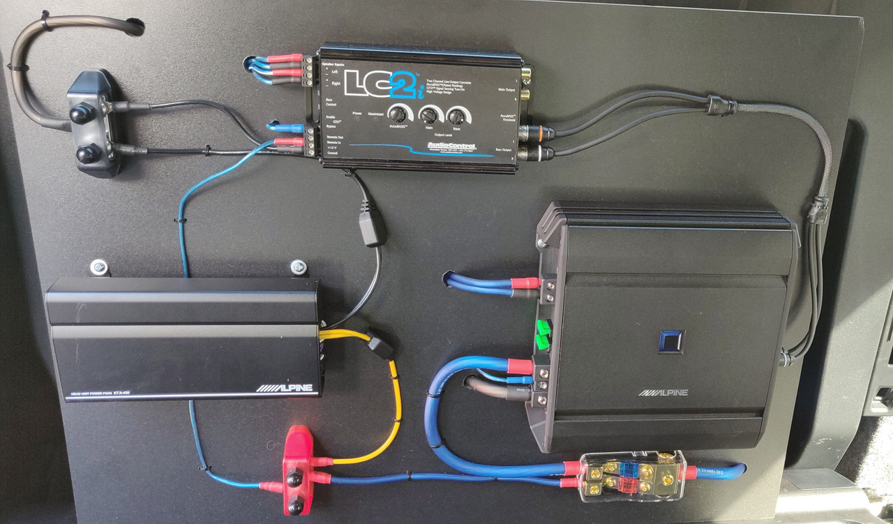

    You have an LC2i right? If so you can use the GTO.....
    GTO™ Great Turn On: No need to look for a trigger wire. However you still need power and ground. Connect the speaker level inputs and as soon as you turn on the factory audio system the LC2i will power up as well. After the LC2i turns on, it provides a 12 volt trigger output to turn on your amplifier. A Jumper which you can reach from the end panel allows you to set this feature on/off for specialized installations. The factory default setting for the GTO™ circuit is always ON.

    yup! Decided to go this route. The LC2i worked like a charm. So for this is what I got and everything is working perfectly. Now I need to trim the plastic so I can accommodate the back seat. As it stands right now, I can't lock the back seat into place. I will have to take a breather and think this through.
