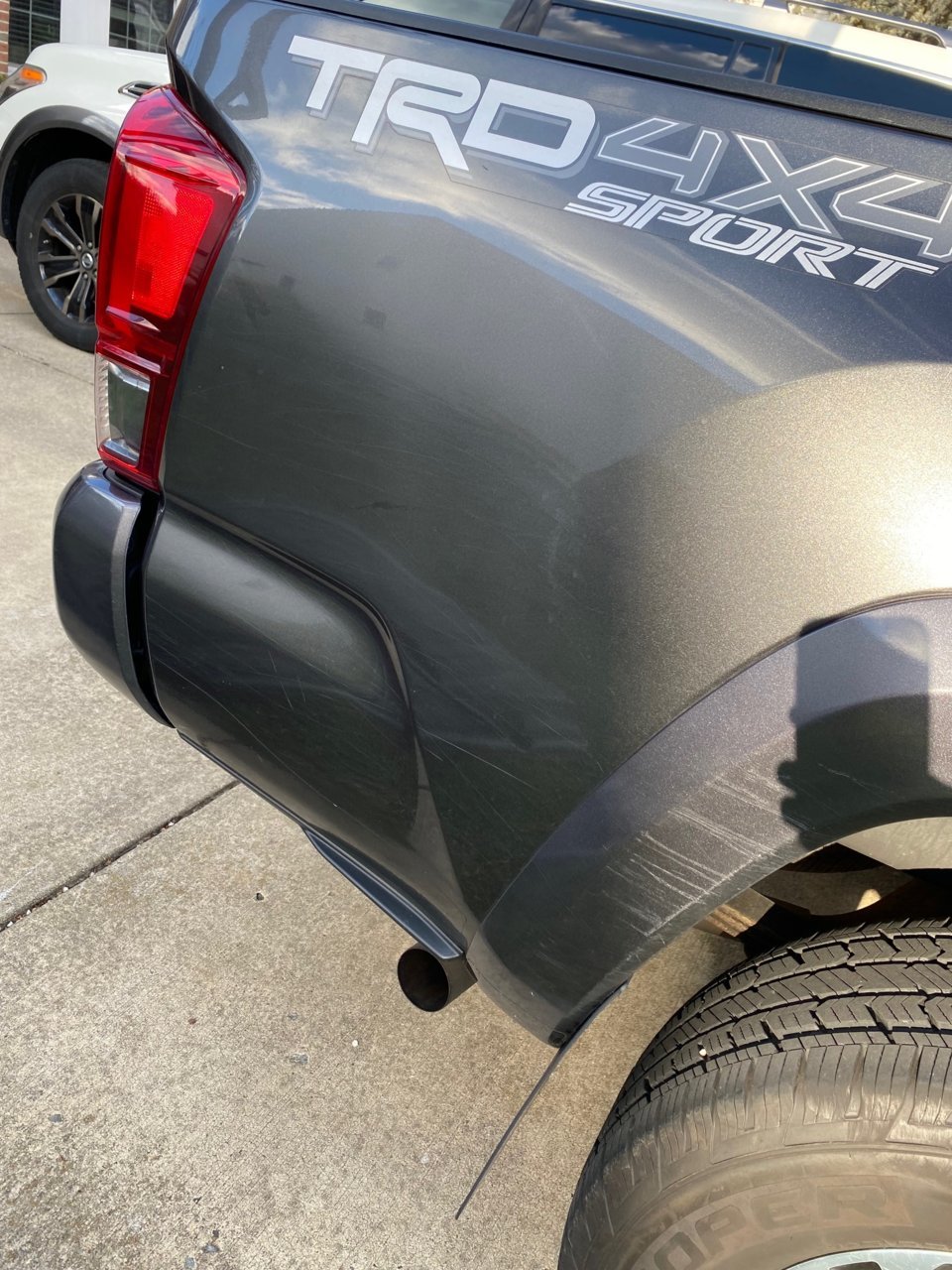

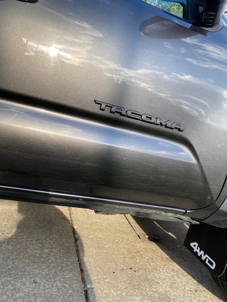

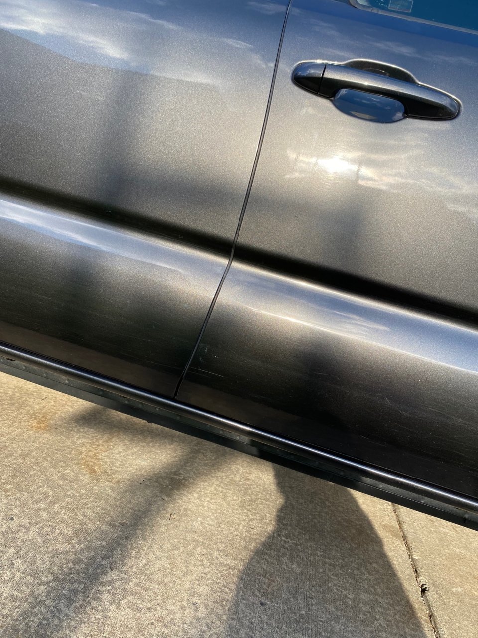

    Calling all body guys…
    Hey all, hope is going well. I’m adjusting well to the taco and am actually liking it a lot, maybe better than my old tundra. Anyway got pretty much most fluids changed and just did the spark plugs saturday (pretty easy). Just started looking at some smaller things to fix, and my eyes caught a bunch of scratches on the passenger side, mostly below the passenger and rear door handles. It honestly looks like someone before me took it off-road, and must’ve scratched it against branches or a tree or something. I noticed some when I went to buy it, and it didn’t really matter that much to me because I liked everything else about the truck.
    I’ll attach the pics below, but I don’t know how easily they’ll show up on camera. They look like clearcoat scratches for the most part, my fingernail doesn’t catch any of them, but it catches a couple of the deeper ones, which is to be expected. My question is, can I take a polisher with a light to medium cutting pad with some clean cut rubbing compound to buff these scratches out? Will it yield pretty good results? Hoping it will make some of the deeper ones a little less visible but I know some will not buff out completely due to their depth. I also plan on getting like a polishing pad with some wax afterward to cleanup after using the cutting pad. I figured I would get the pads from a brand named chemical guys on Amazon, and I already have some turtle wax clean cut rubbing compound. What do you guys think? Any advice? Just hoping to hide as many scratches as possible, or at least make them look less visible. Thanks.
    Brooks
    PS: The worst ones are on the rear quarter panel and the lower passenger and some of the rear door. I know the fender flare ones probably won’t disappear because the plastic itself is scratched.

    Thanks for the input. Yeah, I guess they’re going to get to the point where it makes no sense trying to rub them all out. The pics didn’t upload for some reason, I’m figuring it out

    Thanks guys! I appreciate it! I think I’m going to try some polishing pads to get some of the clear coat scratches buffed out. The pictures have finally been uploaded :D
