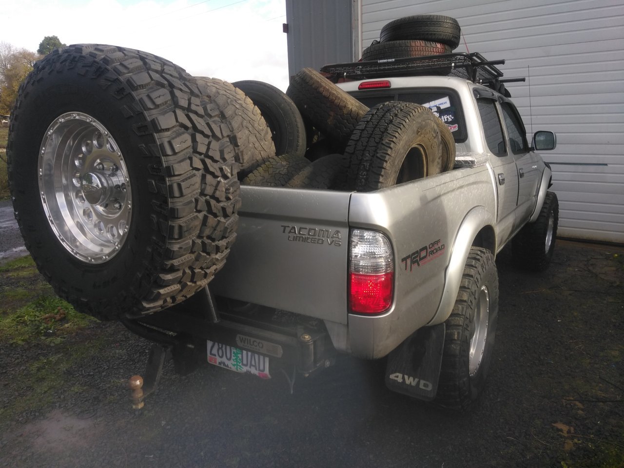

    I ended up with a used Wilco hitchgate cheap, ended up not liking how far it stuck out so I hacked the hitch mount apart and tied it into the factory hitch to make a bumper out of it. Easy enough to take apart single handed.
