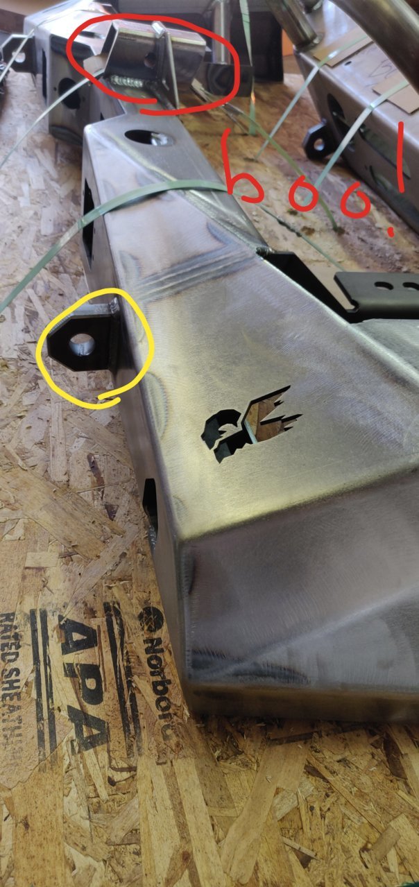

    *Pics
    So option 2 and 3 are out, recover points do not permit. Also have a damn dragging tow hitch but Relentless hooked it up with some product. I'd return but I don't want my bumper to turn into a year.

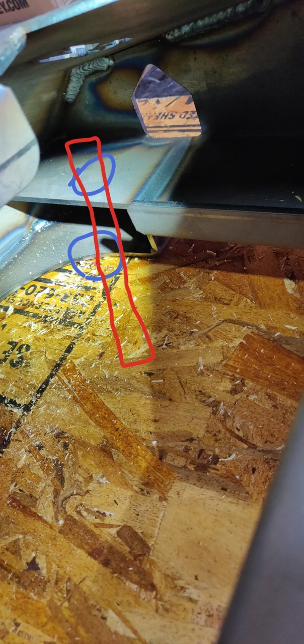

    Internal bumper (upside down), the bracing inside should also suffice as a gusset for the shaft.
    Looks like I'm going option 1. I've always diy drilled holes but this bumper is probably way beyond my cheap bit's range- anyone know of a socal place to get this hole done?

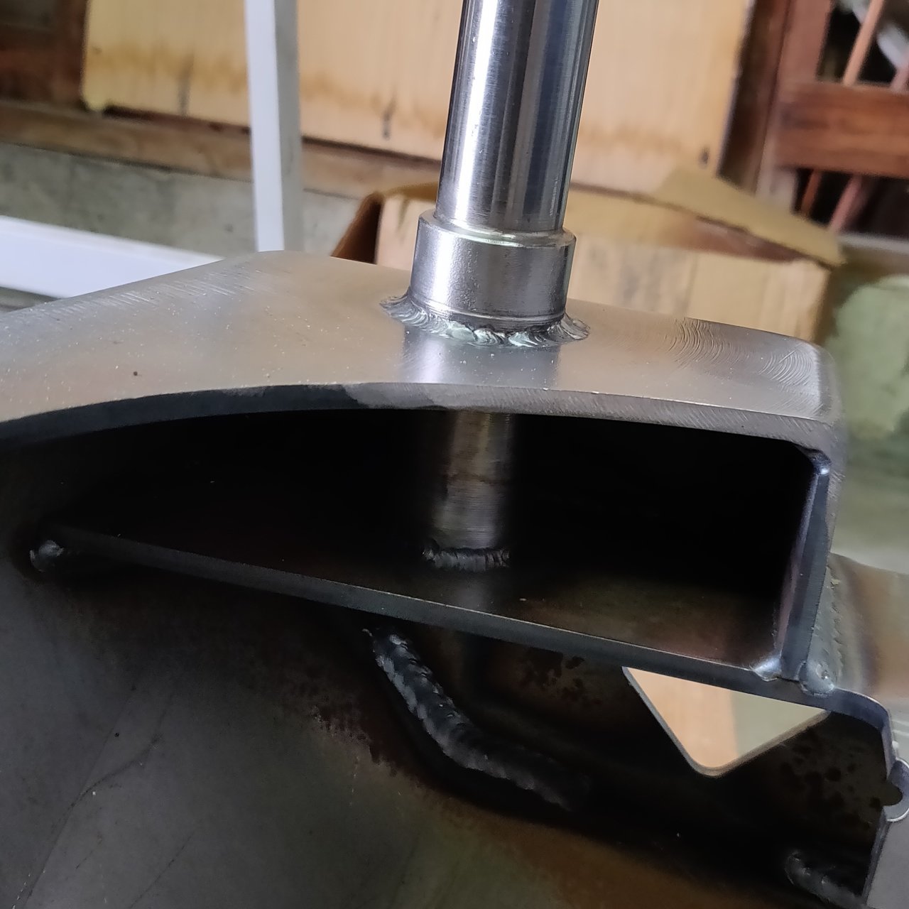

    Oups, yeah. Took the bumper to a guy that does structural Tig welding. He cut the hole and welded it up.
    I bought an Amazon swing out DIY 'kit' where it has the bearings, sleeve, plate for tire mount, latch and little misc odds and ends but have been super lazy at getting tube stock, cutting equipment and having at it
