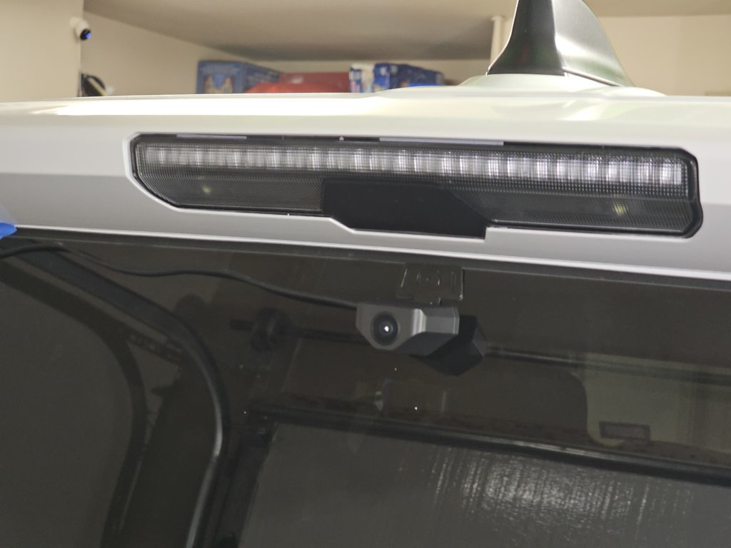

    Does anyone know how to remove this upper outside light? I like to route the camera wire to inside from there.20241011_114013.jpg

    Yeah, you have to pull the headliner and remove the four bolts holding the spoiler on. GG Offroad has a YouTube on it.

    There are four bolts under the headliner that you need to remove. They hold the spoiler on and it gives access to the third brake light. GG Offroad has a youtube on it.

    I initially installed the camera inside the cabin but the quality of photo at night was not great as it was looking through the rear window and I even made a cut out in the Tint to enhance the quality but eventually had to install it outside and hid the wire as was described in the video.
