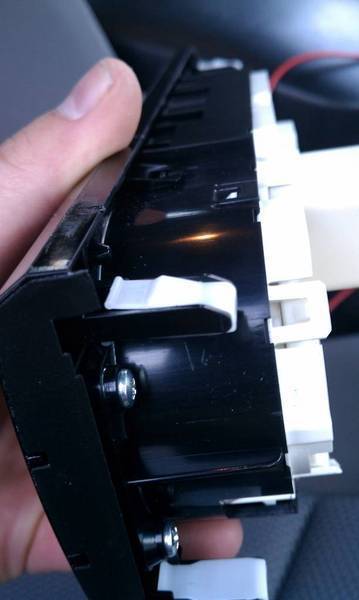

    I had never removed the previous year Tacoma's climate control panel, but when FLYZEYE was test fitting their V2 LED light on my 2012 we removed it. Apparently it is similarly designed but slightly more difficult to pop off.
    Grabbing the knobs and pulling does not work. Just work the area's near the fasteners to get it to pop off with a flat blade tool.

    Oh yeah........ Thanks! Pictures are worth a thousand words. Clips noted top and bottom of the panel..

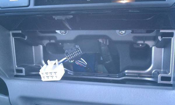

    The wiring connectors are not the same, but the wiring is. If you buy a new connector and pins it'll work plug and play. I'm in the process of doing it now. Found one online cheap and bought it to match my entune upgrade.

    Hello all, I found this topic very useful, as I was wondering how much space there was available behind that panel. I have a somewhat crazy notion that I am trying to consider here, and maybe one of you could answer it for me before I try any of it. First, are those connectors long enough that they could reach down to the cubby in front of the shifter? Would it be possible to relocate the climate controls to that location so I could use the space that they currently occupy?
