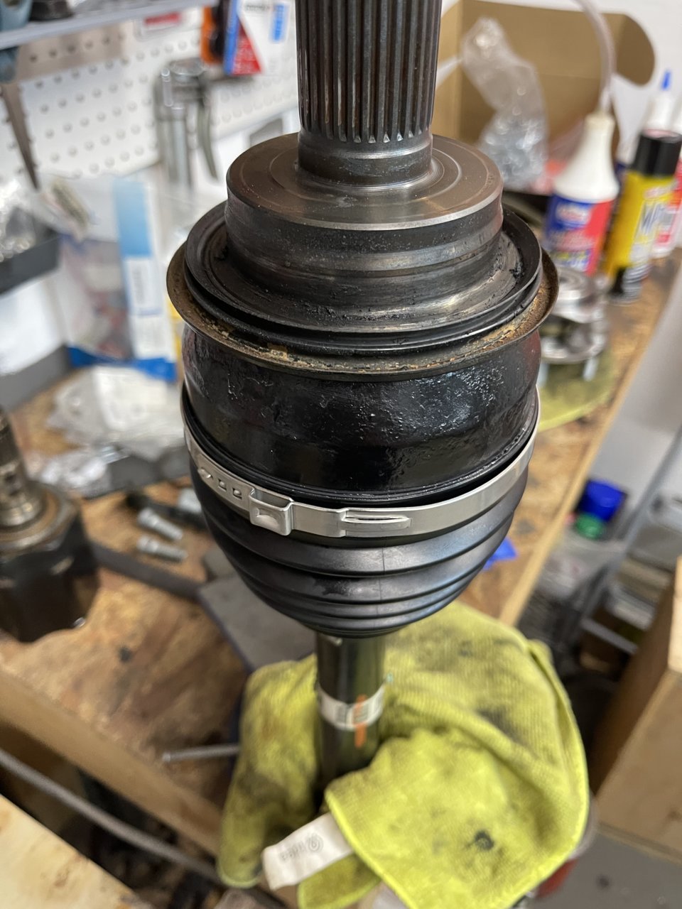

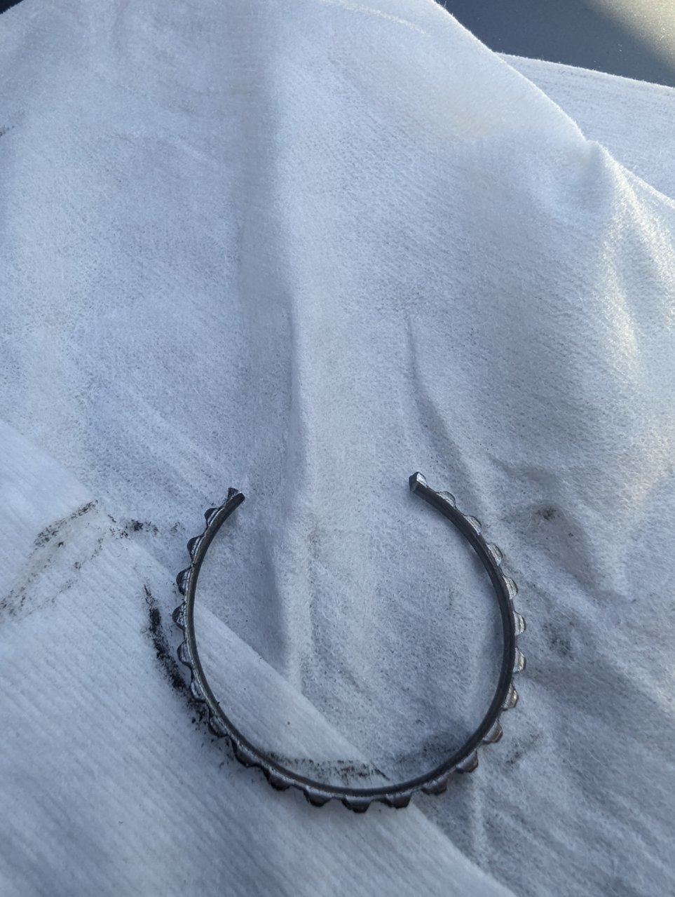

    I emailed Camburg this morning asking if I could by the cerclips from them. They said no, and to call a local axle shop to get help.
    Camburg makes great products but I'm really disappointed with them on this one. It's a tiny part with no oem part number. Being that its critical for their long travel kits to work, I don't know why they don't sell them.

    Get Fj/4runner cv axles, little bit different shaft and c clip so they actually will pull apart.

    I've always used the "slide hammer" pipe method like shown at 5 minutes in this video. I've done this 6 times now for the set currently on my truck and 2 sets of spares I have.
    https://youtu.be/5bTJRzrv4iA?feature=shared

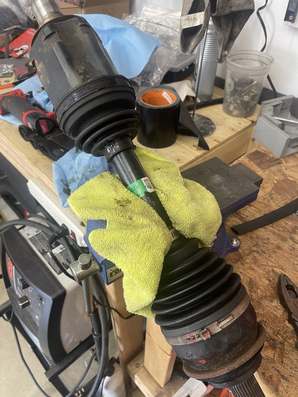

    Success!!!

    Are you rebuilding a stock axle or taking apart for a LT shaft?
    I heard a 50 ton press is whats needed.
    I just rebooted a stock width axle and did not remove the outer part/c clip
