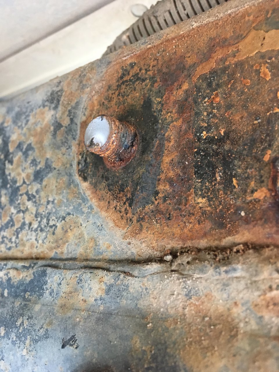

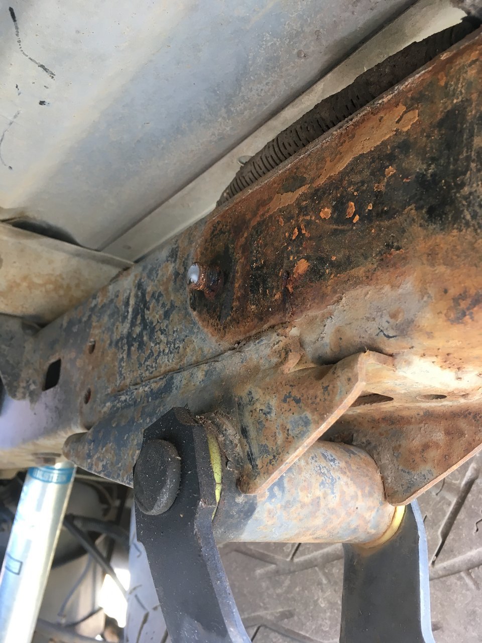

    Anyone got a good idea on how to rep move a broken bolt from the frame? It’s one that holds a bumper bracket. So it needs to come out. Would a left handed drill bit work?

    Clean some of that corrosion off with a wire brush. Spray that thing with PB Blaster Penetrating Catalyst and let it soak 5-10 minutes and repeat a few times. Then grab it with some vice grips and try to get it out. E-Z outs and left hand drill bits work easier with a lot less stub, plus, with enough stub to grab with vice grips, that’s easier anyway. Start with vice grips. If it breaks off or wear down to stub without coming out, then yes a left handed drill bit is a start, but probably won’t get it. Try not to go all the way through! Just get 3/8”-1/2” deep. Then use a left handed tap. The tap will bottom out and start turning the bolt. If you drill through the bolt, then you’ll either need s left hand threaded bolt, or need to place a socket over the bolt and run the tap through the hole in the socket, tighten the ever living crap out of the tap handle and use the socket for the tap handle to bottom on and pull the bolt out. That on is hard to get to work. You need to drill deep enough to tap 5-7 threads(90-98% strength IIRC) but if you go through it does get harder. Start with vice grips!

    Thanks! I’ll give it a shot. If nothing else works, I’ll probably just cut off the welded nut and drill out the rusted bolt. I’m definitely going to try the vice grips first.

    The bolts closest to the front on each side have a welded nut. Comes that way. This is for the bumper brackets.
    I didn't weld anything, nor do I plan to. I figured I could just cut that nut off the back side of the frame and push/drill out the rest of the broken bolt that is rusted in there. Then just use a new bolt with a nut that is no longer welded on. Maybe use some jb weld if I wanted it to be secured to the frame again.

    I have a Gen 2, so I’m not exactly sure what I’m looking at, but the advice above is how I would go about getting a broken bolt out. In the pic I can’t really tell what’s on the other side.

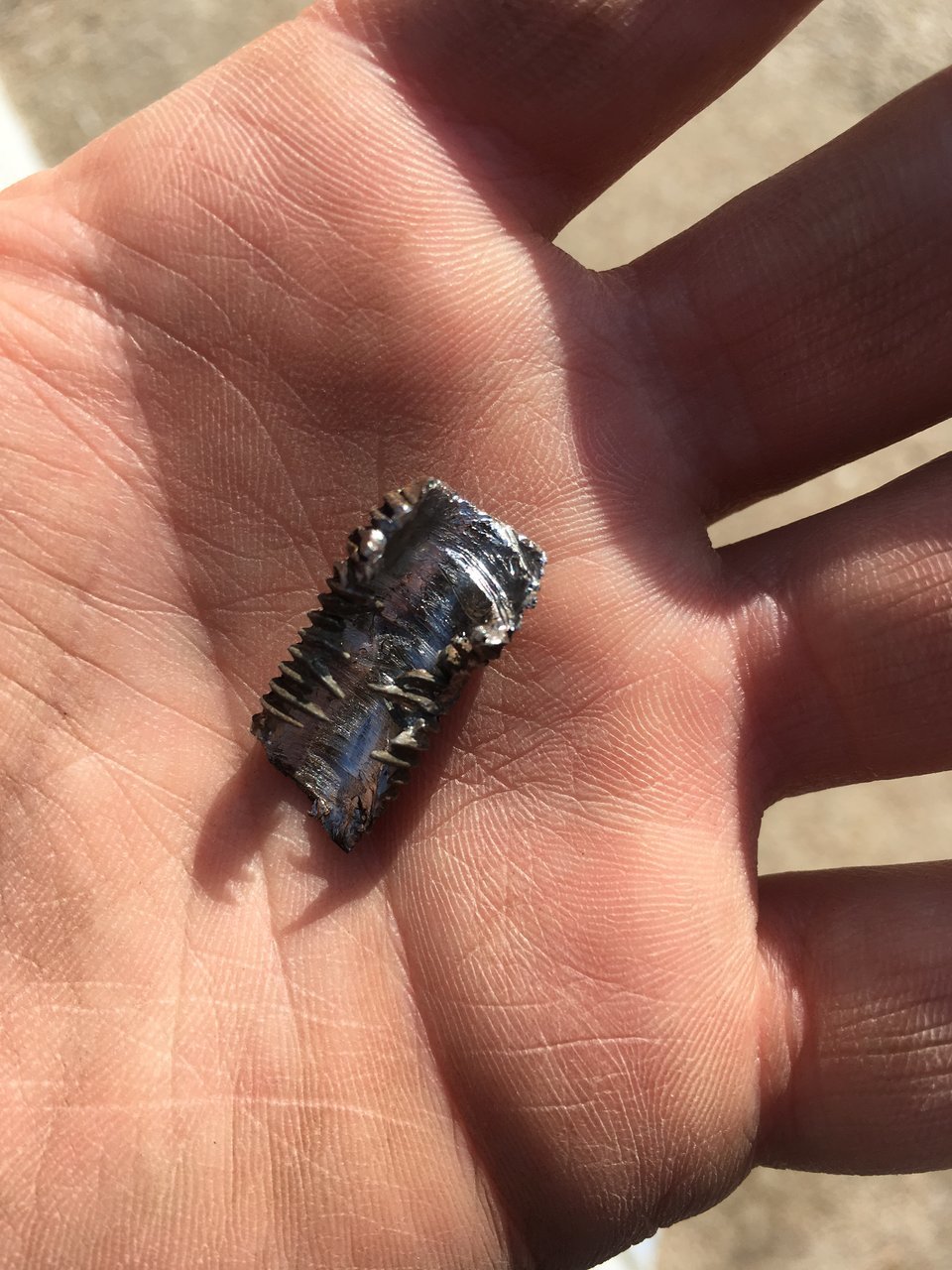

    So I tried the pb blaster and the vice grips. No luck.
    Busted out the drill. Used three different bits to work my up to the correct size and was able to get the bolt out. Had to use a hammer and flat head screw driver to loosen up what was left of the bolt after drilling it, but i got the job done.
    Didn’t have to remove the nut off the frame either.
