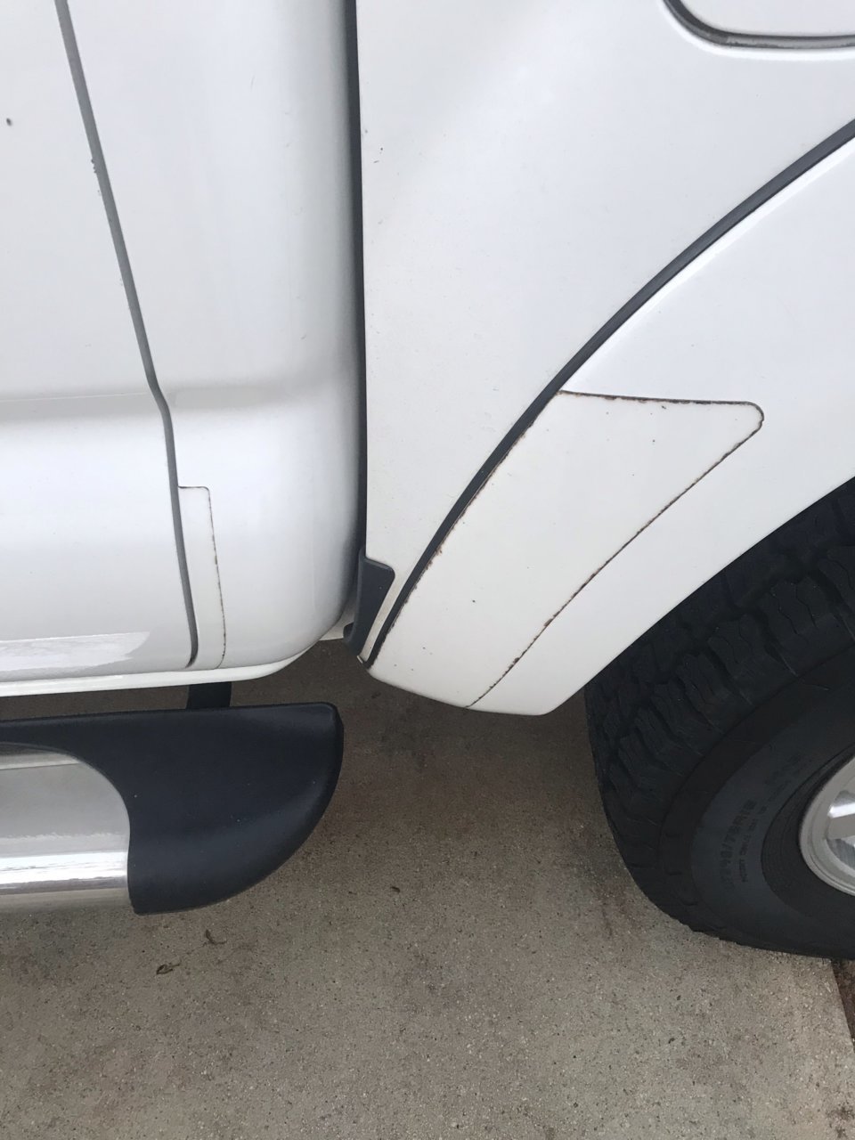

    Did see a thread from 2009, thought I's start a new one about this. The 2006 Tacoma is white and the discolored/mold like edges of the rear qtr panel clear stone guard film looks bad. I have gone the rout of a heat gun, goo gone and some other solvents. It was taking forever and still looks bad, The 3 M film is really not coming off. I spent hours on the one side and still not off. If I could get it off I know where to get it but think I'd just leave it off at this point.
    Also question about ways to repair cuts/scrapes in the front colored bumper. Got a couple that people were nice enough to do in parking lots.

    Well I finally stumbled on an answer for the removal of the old hardened stone guards, Turtle Wax Sticker and Label remover---worked really well. No heat needed. Use that stuff and a plastic razor blade. Nice results for $6.99!

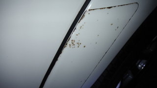

    I have a white '11. My stone guards look just like this picture and even an little worse.... black mold/dirt around the edges....
    Also, I hit one of them too close with a 3500psi pressure washer one day and it tore the hell out of it.
    I would love to try taking them off, but don't want to get halfway into the job and realize I should have left them alone.

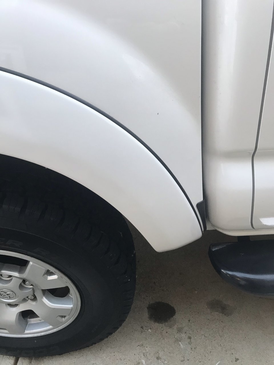

    As mentioned I tried all kinds of things. I was ready to buy one of those expensive eraser wheels, boy that would have taken some time. The Turtle Wax Sticker and Label remover IS THE STUFF! Got it at the Auto Zone store. Spray it on, let it soak, spray it again. Could not find locally, but online there is a plastic razor blade scraper that would work well. I got a couple of black plastic wide putty blades from Home Depot, nice edge and won't scratch. The guards will peal off, may have to reapply a couple of times, but even the goo will come off. For under $10 nothing better or easier, especially for old baked on guards like mine were. Cleaned the area with MEK, then applied a coat of wax and polish. Looking good now!

    I used the Turtle Wax label remover today!

    It worked great! Still need some elbow grease and some plastic scrapers. Each side took about 45 minutes.
