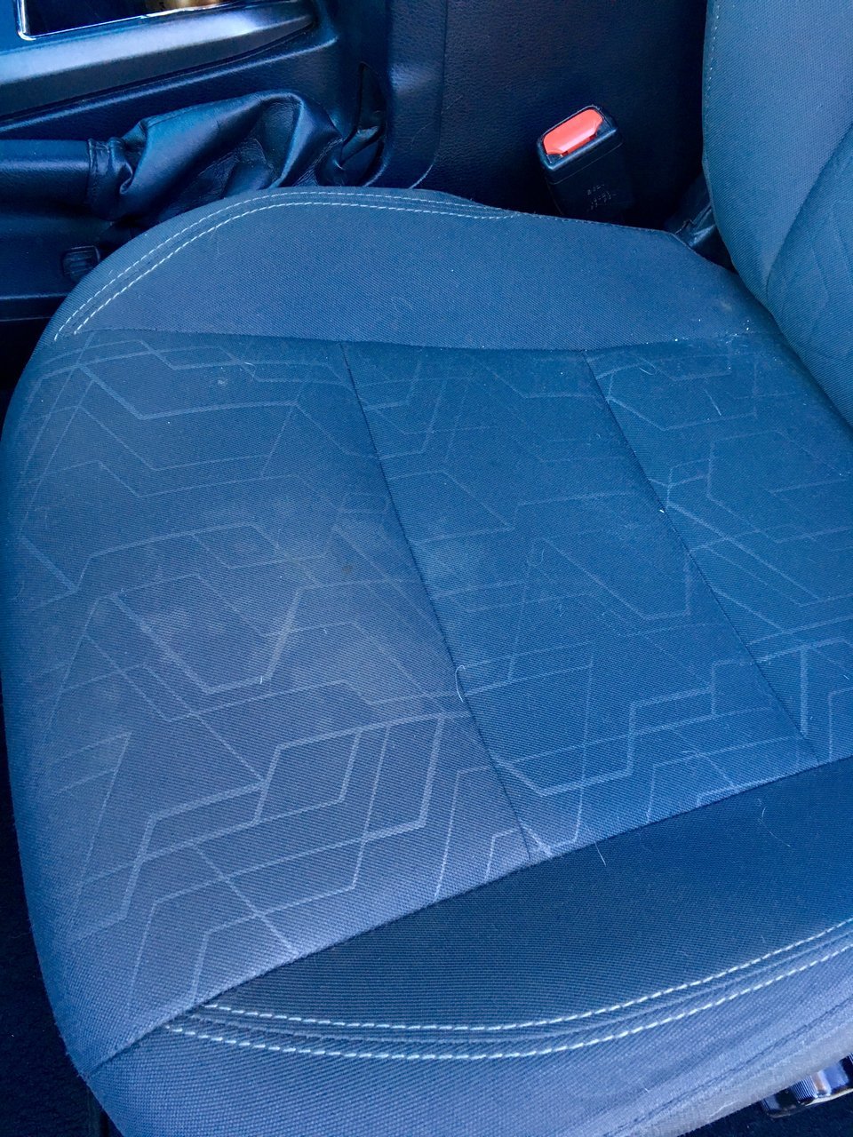

    For some reason, my dogs drool has stained my cloth seats..any tips on how to remove the stains/blend them in with the rest of the fabric; I kind of cringe every time I get into my truck lol

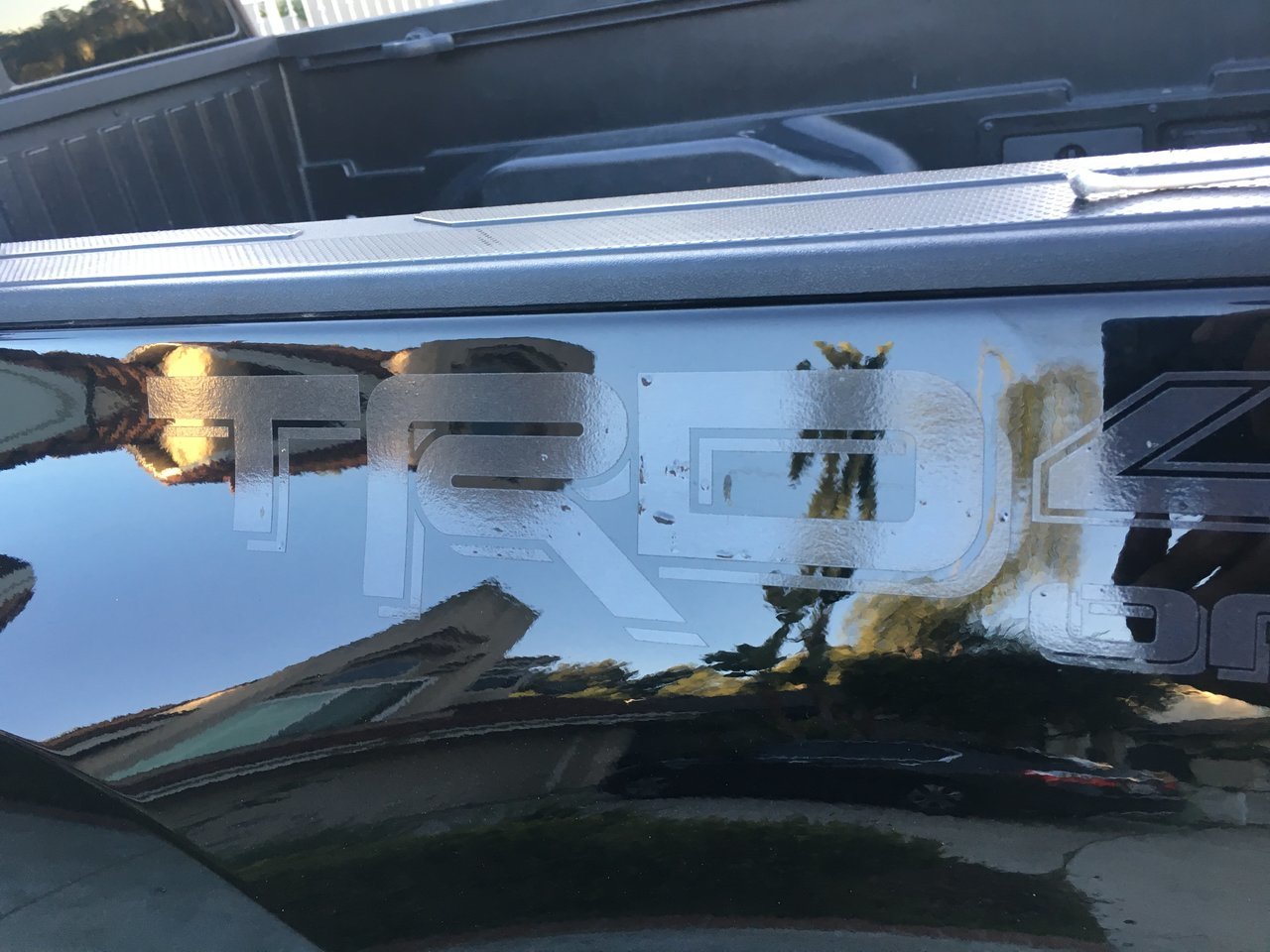

    Next, I installed these new TRD OR decals about two weeks ago and have some bubbling..What is the best way to get rid of them?

    steam cleaner, then get seat covers ( good ones )... razor blade ( make small incision on sticker then press with credit card to smooth out ).....at least thats what i did to fix mine

    Will the stair cleaners you can rent from Home Depot work?

    i got a steam cleaner from Fred's ( like dollar general not sure what ya'll have out that way ) for like $75...but i assume any kind of steam cleaner will work just make sure you mix it correctly or it'll leave a white residue on dark cloth and make sure you have the time to let it air out when your done

    1. Don’t let animals in your car. Stop the staining at the source.
    Clean the seats with some soapy water. If you have to go for a fabric cleaner. Allow the seats to dry completely then cover the seats with a can of scotch guard. Will prevent future staining.
    2. Take the decals off with a heat gun and a delicate touch. Buff off all excess adhesive. Then get new decals and apply them more carefully with a sqeegee.
    Air bubbles are from not applying correctly

    For decals I usually spray with water first then apply the decal and squeegee out the water so there are no bubble. It also allows you to reposition if necessary.
