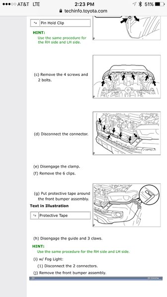

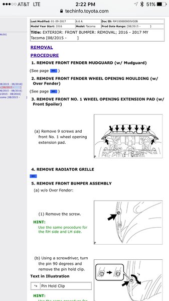

    I want to remove the whole bumper! Under the grille and headlight housing... I know about the grille and etc. I want this whole plastic off (in red).
    IMG_6035.jpg Is there a diagram?

    Here you go

    Can't see the diagram... @ 59 yrs old..and glasses... is there a larger diagram?? :smash:

    Thanks but no love here bro... I use Firefox ... can view in separate window and enlarge ... business end of write up is cut off and blurry once it gets larger.....
