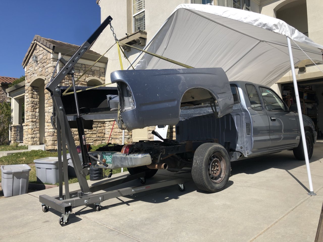

    So it’s actually really easy to remove the bed and it makes servicing the tank 100x easier. Advantage is you don’t need to drop the tank at all. You can change the pump with a full tank still bolted to the frame. I did it by myself with an engine hoist. I’ve also done it by lifting the bed off with three people.
