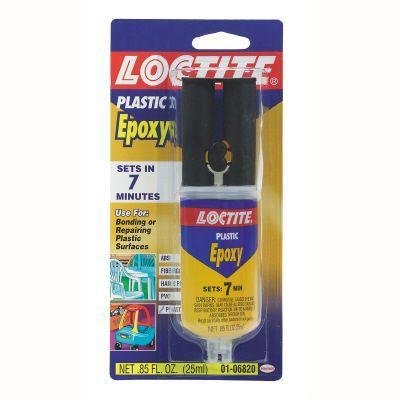

    this is what im doing too. what kind epoxy you using???

    2 part plastic epoxy... u can find it at any home store and possibly and auto store as well.
