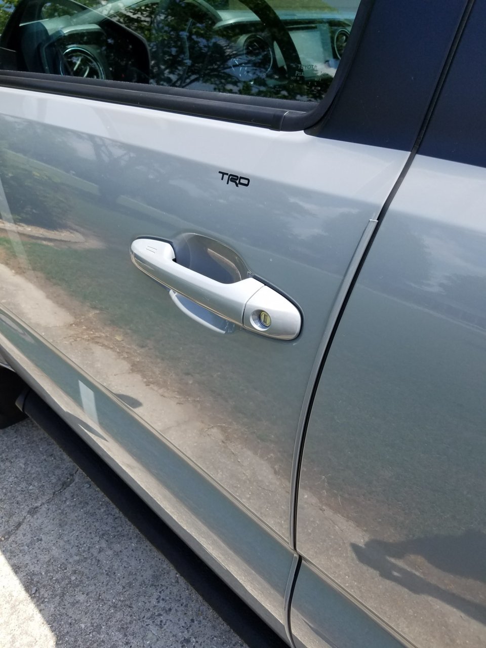

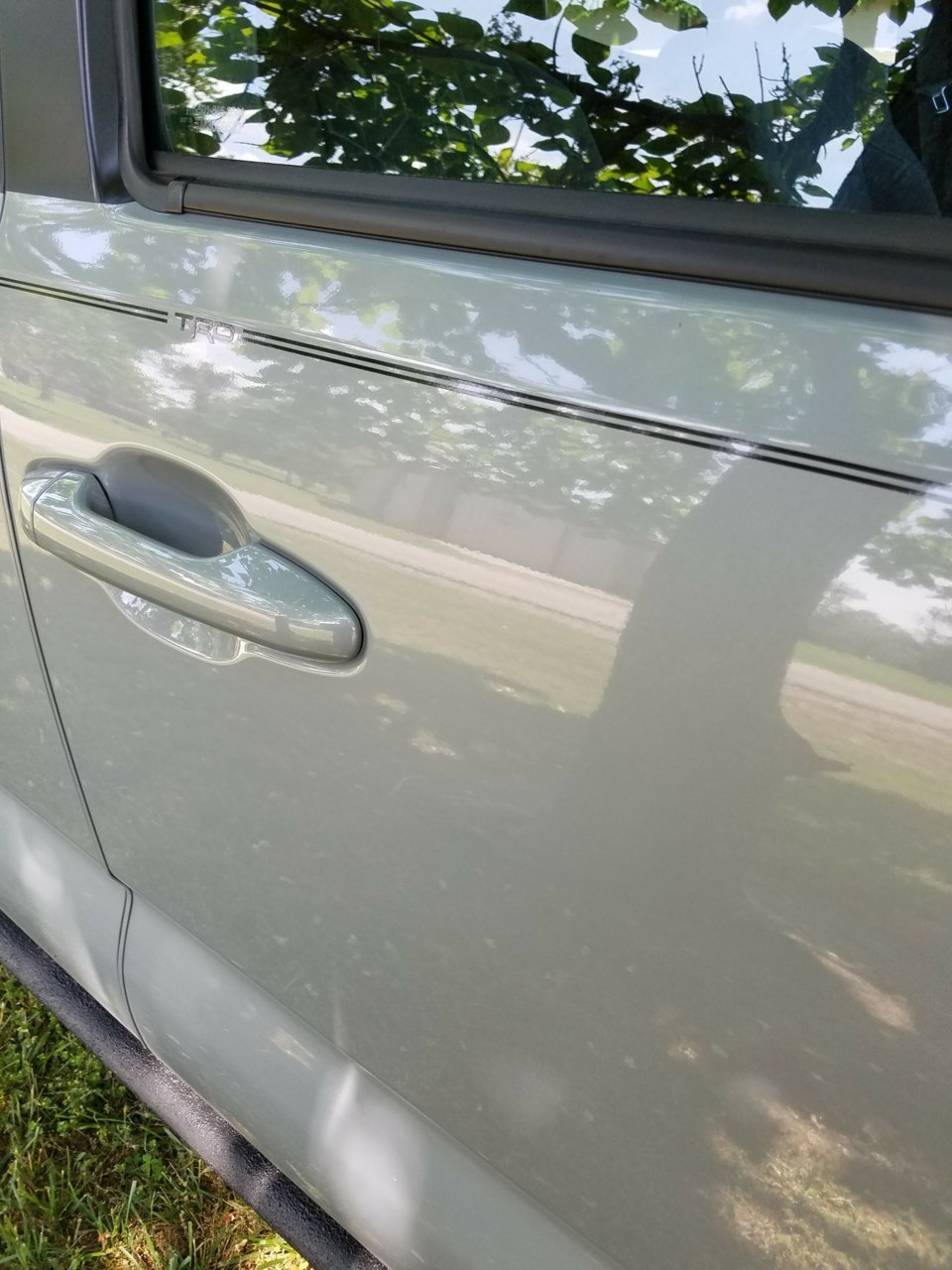

    Mine came with pinstripes. Heat with hair dryer, peel off, Goo Gone for sticky stuff, wash. 20180528_112301_001.jpg 20180528_112621.jpg 20180528_122400.jpg
