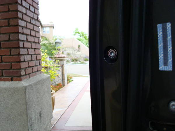

    Start:
    Step 1:
    Open door and locate black plastic cover.
    Step 2:
    Remove plastic cover. I just used my fingernail so I wouldn't scratch the paint.
    Step 3:
    Using #30 Torx Screwdriver loosen the screw all the way. DO NOT worry about the screw falling into the door. It has a retainer clip holding it in place. DO NOT try to remove the screw all the way out.

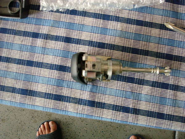

    Step 4:
    Slowly remove the lock mechanism. I used my fingernail to pry it away from the door and used a rocking motion to wiggle it out.
    Step 5:
    Remove black cover from lock mechanism. You will now use the screwdriver to pry the cover from the mechanism.
    Step 6:
    Handle removal. WITHOUT pulling up (like you were going to open the door), slowly slide the handle back towards the opening until it clicks out and pull out of door.
    Step 7:
    Insert new door handle into opening and slide it forward into place.
    Step 8:
    Replace new cover onto lock mechanism.

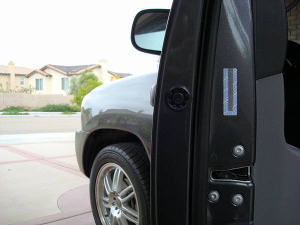

    Step 9:
    Slowly insert the lock mechanism into the door. Then with one hand holding it in place, use the other hand to tighten the #30 Torx screw.
    Step 10:
    Reinstall black plastic cover by snapping it into place.
    Removal/Replacement Complete.
