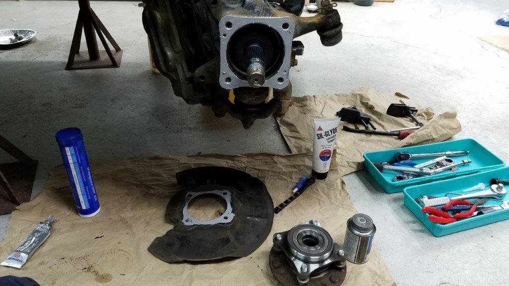

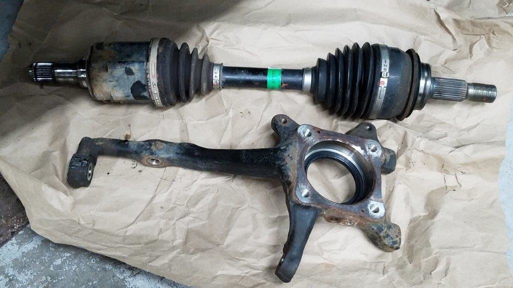

    I'm sure it's a dealer only part. I've done 5 of these and only removed it once and I reused the o-ring. I cleaned everything up and added some RTV to the flat mating surface of the speed sensor- where it contacts the knuckle.
    I also add a thin coating of RTV to the knuckle and the mounting surface for the bearing on the rotor shield- basically seal both sides to the rotor shield. There's an o-ring on the bearing but it's obvious that water reaches the outside of that o-ring as there is corrosion on those mating surfaces. This will make more sense when you take it apart.
    Even if you add some RTV, you should change the o-ring on the bearing and it's a dealer only part. Water reaches it and the machined bare metal transfers rust to it and craps it up.
    edit for pics. You can see the rust on the spindle where it mates to the rotor shield in the second pic. The o-ring is on the bearing housing and seals to the chamfer on that bore in the knuckle. You can see the rust here. O-ring is shown in the first pic installed on the bearing.
