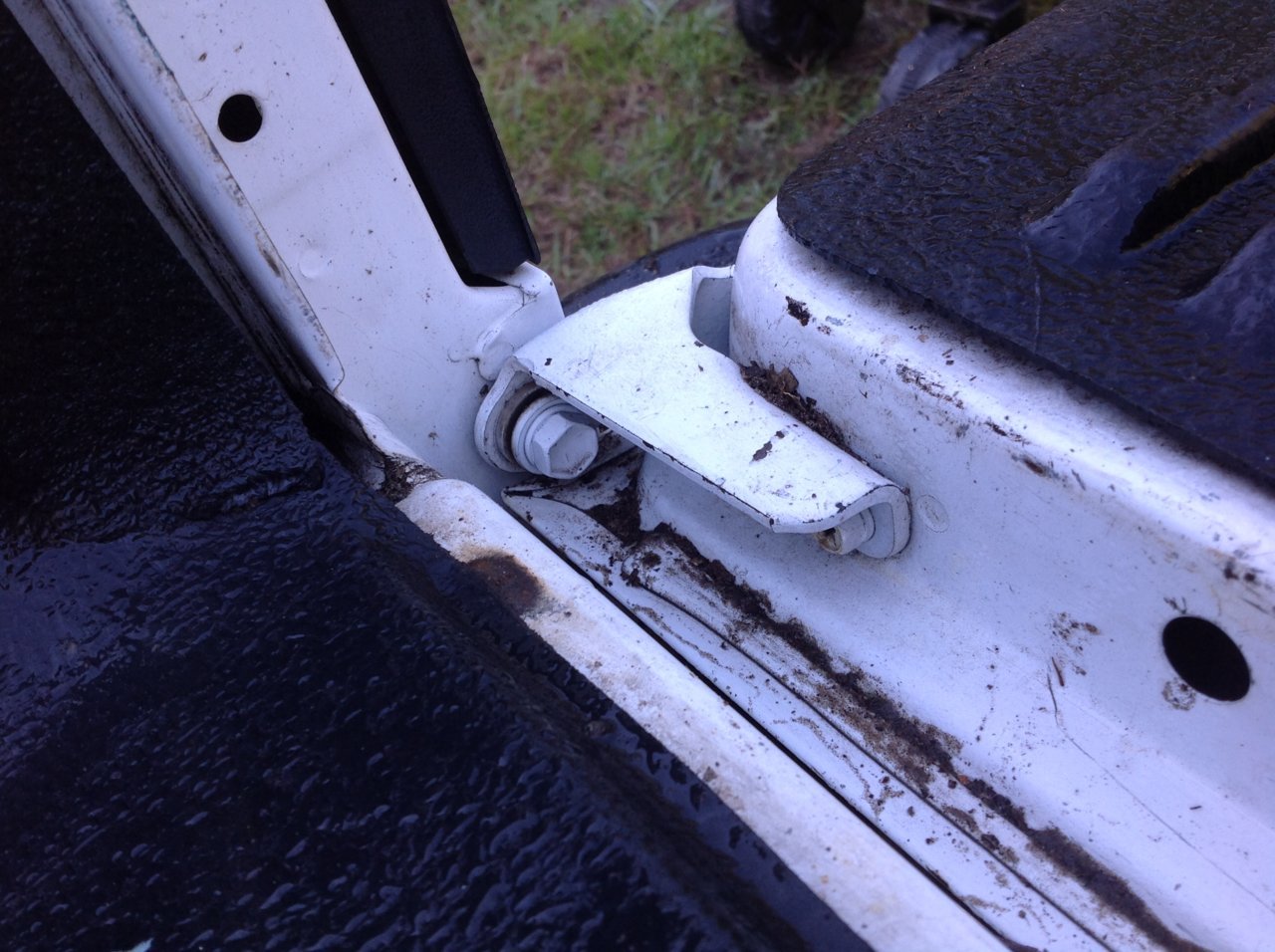

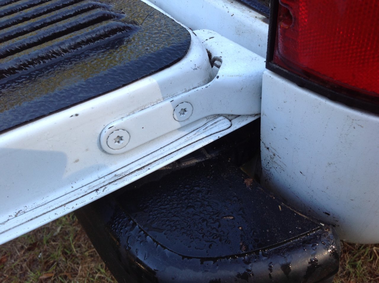

    I need to take the tailgate off my 2004 prerunner. I am not sure which bolts to loosen, the single pivot bolt attached to the base of the frame at the two corners, or remove the screws and bolts that hold the tailgate to the brackets at the bottom IMG_1954.jpg

    The first picture. The big 14mm. On both sides.

    The bottom one in your first picture.
    You'll need to lift up the tailgate slightly so you can pull it out of its groove for removal.

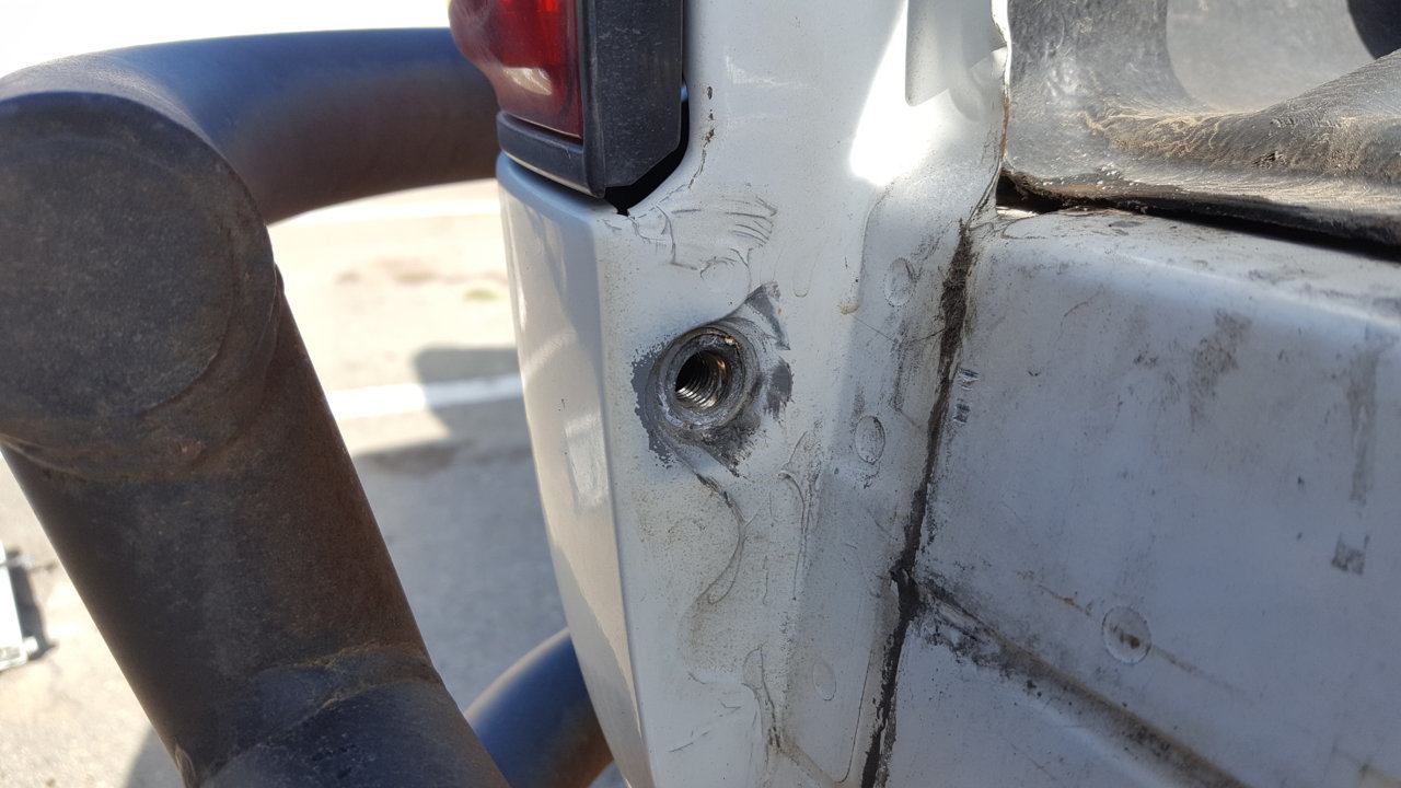

    Thanks! So, can I get back inside the frame if there is a nut or lock washer or something similar that comes loose when I pull that bolt out?
  5. Jan 28, 2020 at 7:22 AM
    Kwikvette
    Feb 27, 2019
    #284735
    80,773
    Fresno County
    4 run, 2 don't
    Nothing but a bushing on the tailgate itself

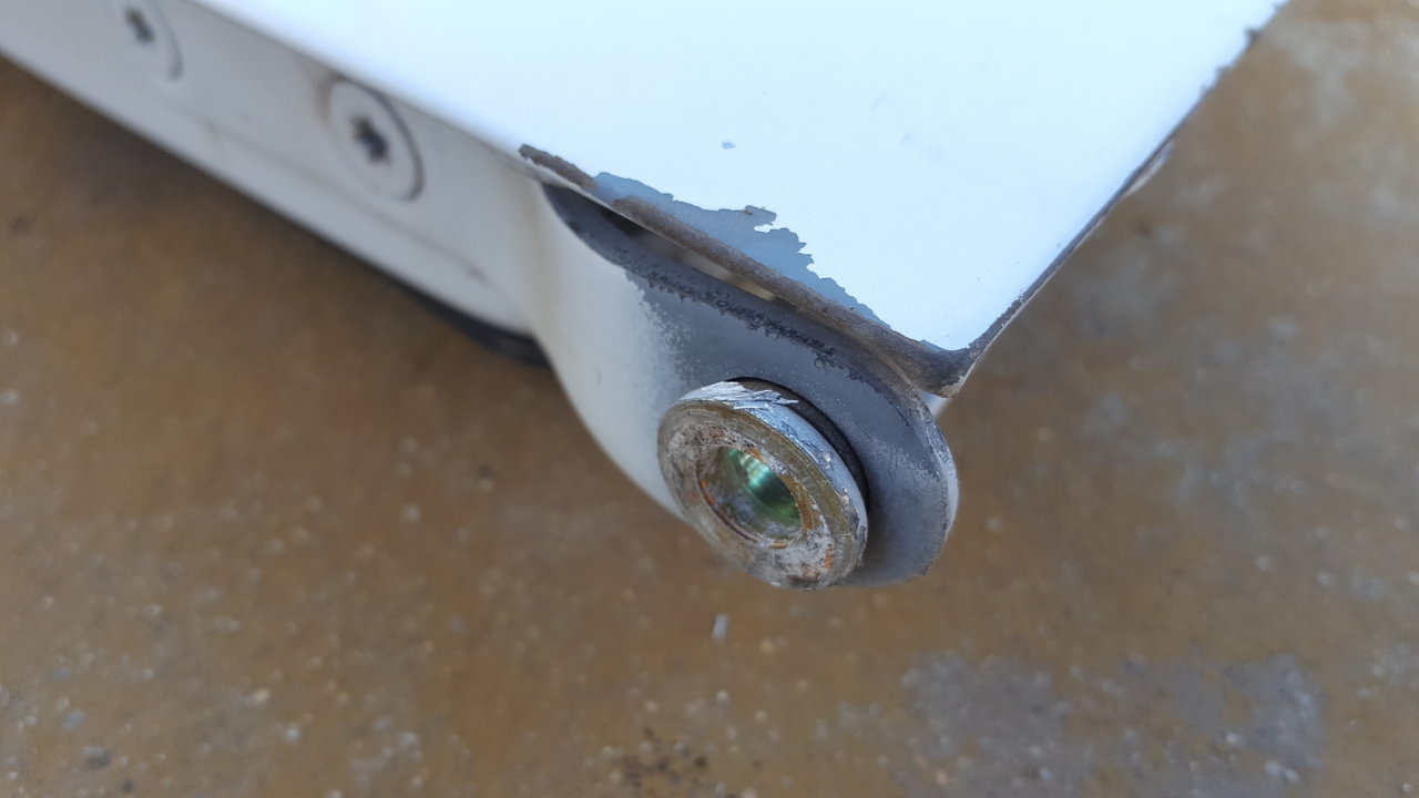

    Removing the tailgate is literally a 5 minute job.
    Just take note of the last pic I posted as you can see how you need to "guide" the tailgate through the small channel to get it out.
