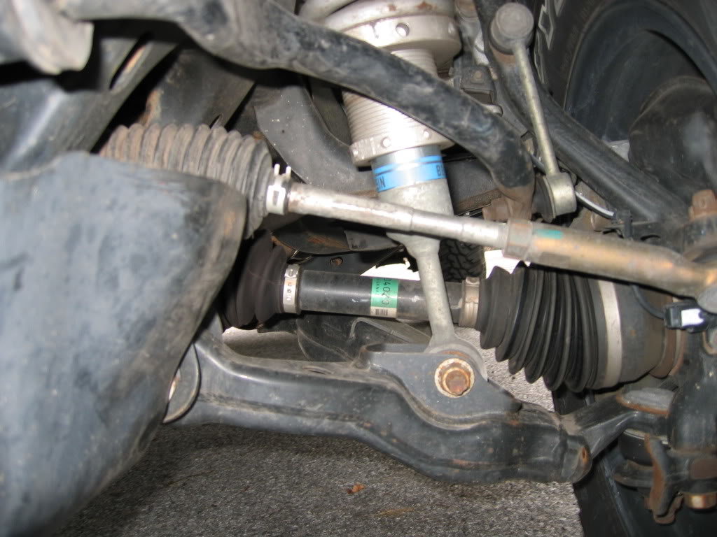

    Photos thanks to Neubs. See for yourself the difference in CV angles.
    Before the diff drop.
    After the diff drop kit was installed.

    Those pics are taken at different angles. Truthfully, given the different angle of the shots, the axel angles look the same. the diff drop, drops the front of the diff 1", and lowers the axels just over 1/4". hardly enough to make a difference.

    Yep, notice I didn't make any claims of a radical difference. My drop lowered my differential about 3/8".
    The photos might look the same to you by your best estimation but your not saying that it makes no difference right?

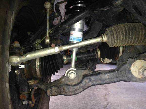

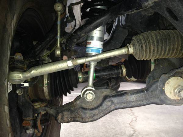

    In case anyone is wondering what the difference on the angle of the CV boots looks like, here are before (with diff drop) and after (without diff drop) photos.
    Unlike other photos I've seen that were taken from different angles, which skews the perspective and doesn't reflect the actual difference in CV angles, I ensured these photos were taken from the exact same position and angle. As you can see, there is a slight difference in the angle of the CVs, but not so much that I would consider it significant. As others have stated, I'd much rather have to replace my CVs a touch sooner and not face all the potential problems discussed in this thread.
    with diff drop
    without diff drop
