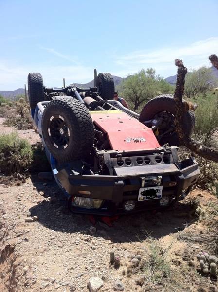

    With skid plate like this I don't think MJP2 would had have the same problem.
    I do agree with chris4x4 that without the DD it would had been less damage.

    ^^^^Skid plate definitely saved the differential in this case :rolleyes:
