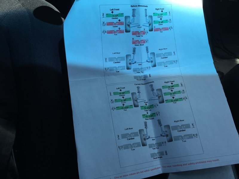

    One thing not mentioned with the drop kits and front lifts is alignment specs. Wouldn't a 1" diff drop kit help bring the alignment back to factory specs? I only say this because I do have this diff drop kit on my truck. Here is my alignment before and after with diff drop installed. I may not have that extra clearance in front but I like how the truck handles.

    3,512
    No. Not at all. It has zero affect on wheel alignment.

    So put the drop kit in,take it out,put it in,take it,what a mess and waste of money if nobody can agree on anything,I put mine in because most everyone here on this site said yes put it on if you are lifting your truck,now its take if off.What gives.

    Take it off....I don't know anyone who reccomended it for a second gen..
