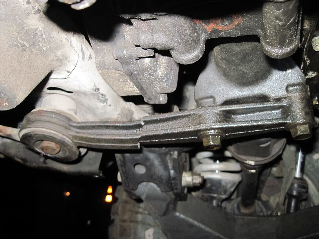

    Look at this picture and tell me how much that inner CV is dropped when the front is lowered 1":
    You really believe it's helping your angles?
    It was a hairy, blind section of the course. This happened at 20mph.

    I don't think Ray Charles could have seen this coming. Anyone know why?
    Regarding the "debate": For some people, maybe a diff drop makes sense. And I'm not sure MJP's issue would've been avoided if his diff wasn't dropped. Me...I'm gonna make it prove it's necessity before I consider it. Everything I've read leads me to believe 3" or less is fine without a FD drop.
    Larry, IIRC, when you shredded your CVs you were way jacked up on the coilovers, something like 4" in the front wasn't it?

    I know I'm being outspoken minority here (and I have virtually NO experience with this...)
    Looks to me like the DD wasn't at fault - I mean, the spacer looks pristine. So IT didn't fail. The failure looks like the skid plate, and those drop downs didn't help the matter.
    Why do I say that? I'm guessing that the drop-down caught the rock, right? But the skid plate still bent, and that was what actually caused the damage. I don't know what brand skid plates you're running, but I'd talk to them and say something like "Dude, your metal didn't hold and really jacked up my truck. WTF?"
    Are DD's bad in the first place? I don't think that should even be the point of this thread - but again, I defer to those with more knowledge. Better road armor should be the real point, or at least FAILURE of the skid plate. (someone else pointed out that there are skid plates that should fit over the DD)

    The diff drop only drops the axel shafts about 1/8". The only reason I say "1/2" " is I try to give a "Best Case" scenareo.

    Impossible. The differential would have to be mounted near the center of the support arm for that to happen. Again, look at the picture I posted. It's mounted at the rear of the arm, so you're looking at about 1/8" of drop.

    Also....People seem to be missing that the spacer is going to allow forces to be amplified to the cross member when/if hit. Mike was only going around 30 mph ( if that), when he hit the rock...or whatever it was. The impact was a glancing one. about 6" or so ahead od the DD. Had the DD not been installed, the force would not have been exerted to the the cross member in the same mannor. Im making a demonstration with my hands SHOWING you guys exactly what Im talking about....WHY arent you seeing it???? :p

    This is exactly my point. The differential drop itself didn't fail, but it puts critical parts in harm's way while providing 1/8" of benefit.
    The skidplates were modified to clear those spacers. Had the spacers not been there, the bottom would have been smooth and I would have slid right over the obstacle without suffering any damage.
    As for going with other skidplates, All Pro and ATO do not protect the lower control arm mounts.
