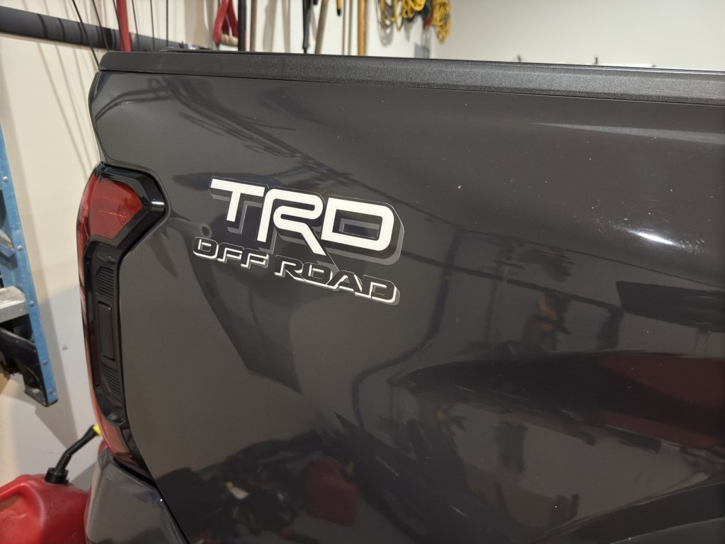

    I’m told by a body shop that these are removable stickers. Has anyone removed these and can confirm the paint is seamless beneath?
    Also is it easy to remove the TRD sticker on the rear of the bed cleanly? Would this hurt perceived value of the truck?

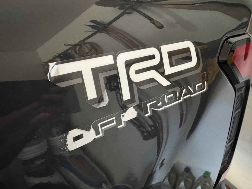

    Top portion comes off fine, bottom portion is nightmare fuel. Worried about heating the paint too much. Industrial heat gun, low setting, 2-3 inches away.

    Yep - that separation was my experience. Patience needed, it’ll come off.

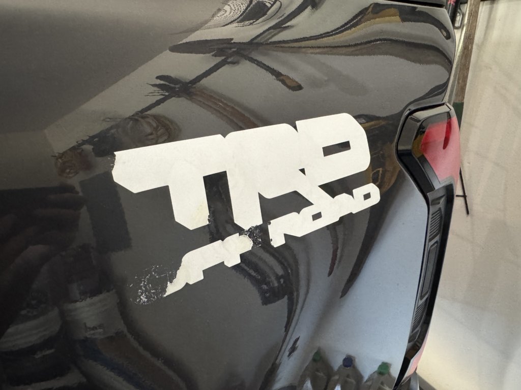

    This is the most tedious thing I’ve ever done. Super hard to get off even with the heat gun. It’s going to take all day for just one side.

    This is good. Once you have the top layer off, use a "whizzy wheel" on fairly low speed and the thin all white layer will come right off. I did mine and worked great
