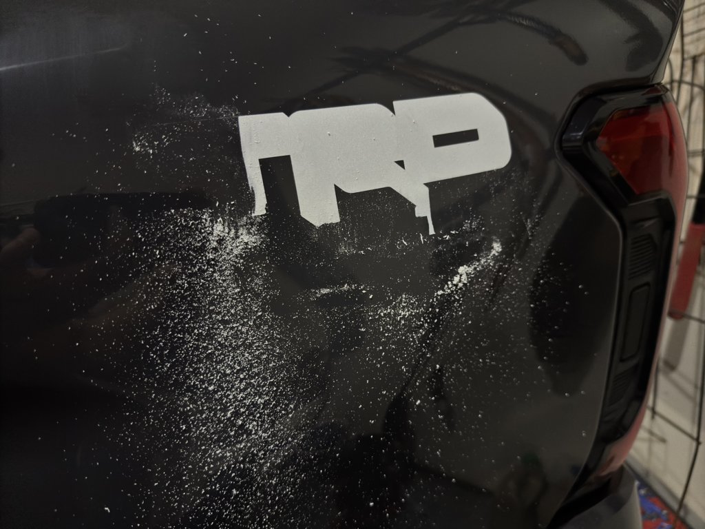

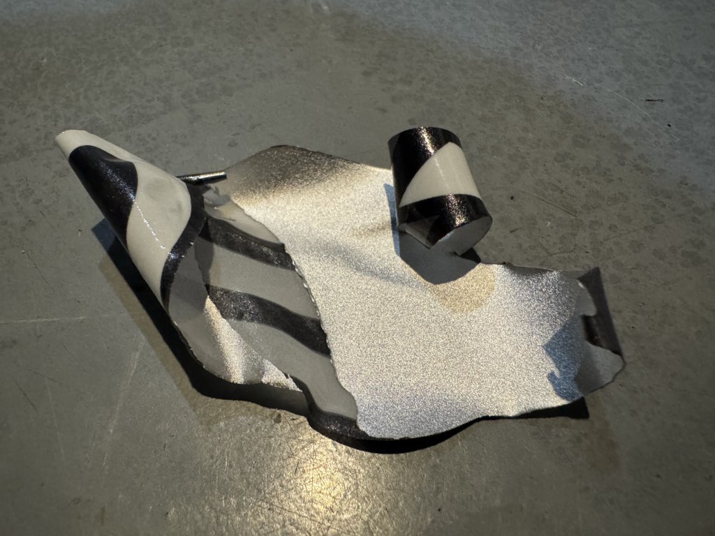

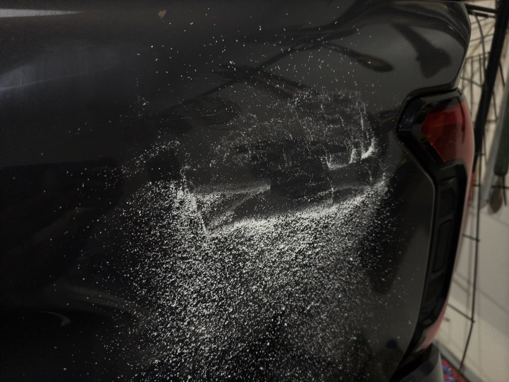

    This is the way. Using the corner of the rubber disc in low RPM setting of DeWalt cordless is making quick work of it. Done in 2 minutes.
    Appears the previous gen decals were single layer vinyl or some other stretchy material, but these are two layer with crazy adhesive. Removal of the other TRD decal will be as follows:
    - Heat and remove outer vinyl layer with heat gun on LOW, 2-3 inches away using constant moving motion
    - Use corner of 3M adhesive removal disc at low RPM to remove adhesive layer in thin strips from top to bottom working left to right
    - Remove debris with wet towel and wipe one pass with adhesive removal compound
    - Light pass with polishing compound to remove any swirls / imperfections
    - Re-wax

    You could be right here regarding long standing, even heating of the sun.
    Trying to apply more gradual / even heat with the heat gun on the other side still left the white adhesive behind, but it appears there is a third / middle metallic layer that didn’t come off with the last decal.
    In the end, I had great results removing both decals with the method above. If I had to do it all again, would take about 30 min total.
