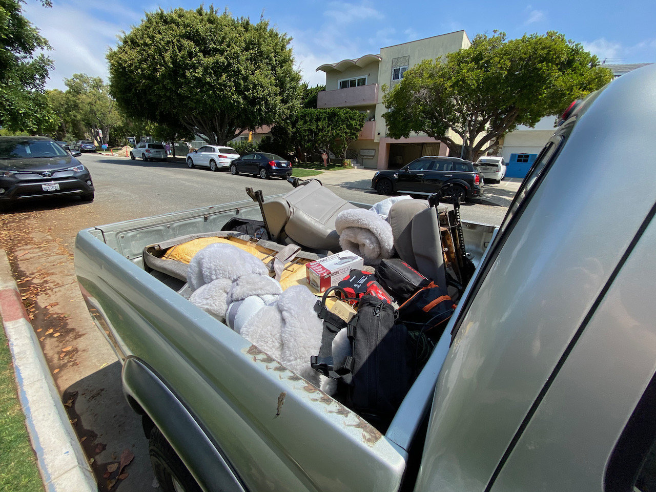

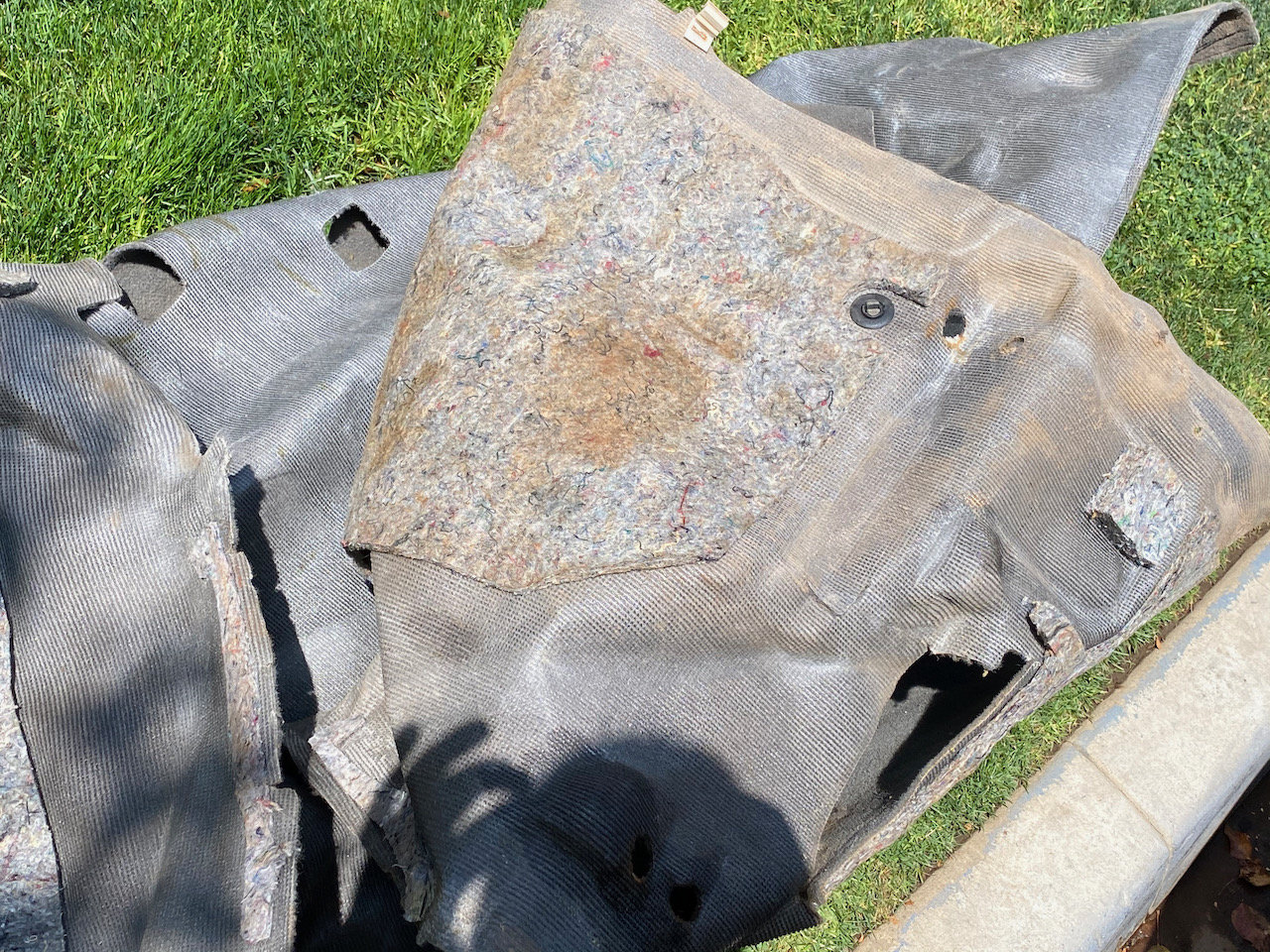

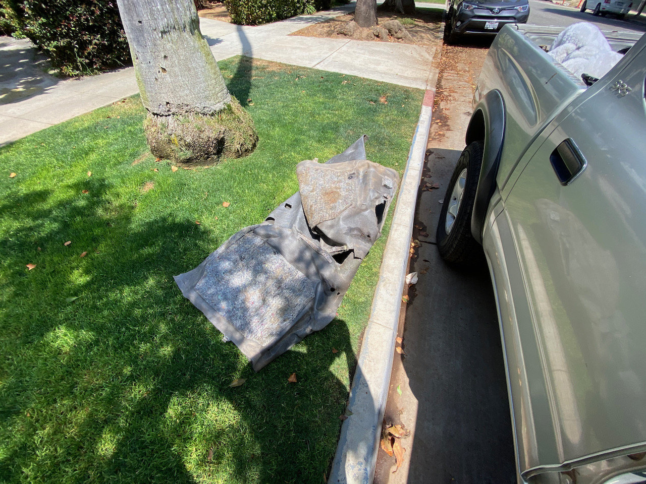

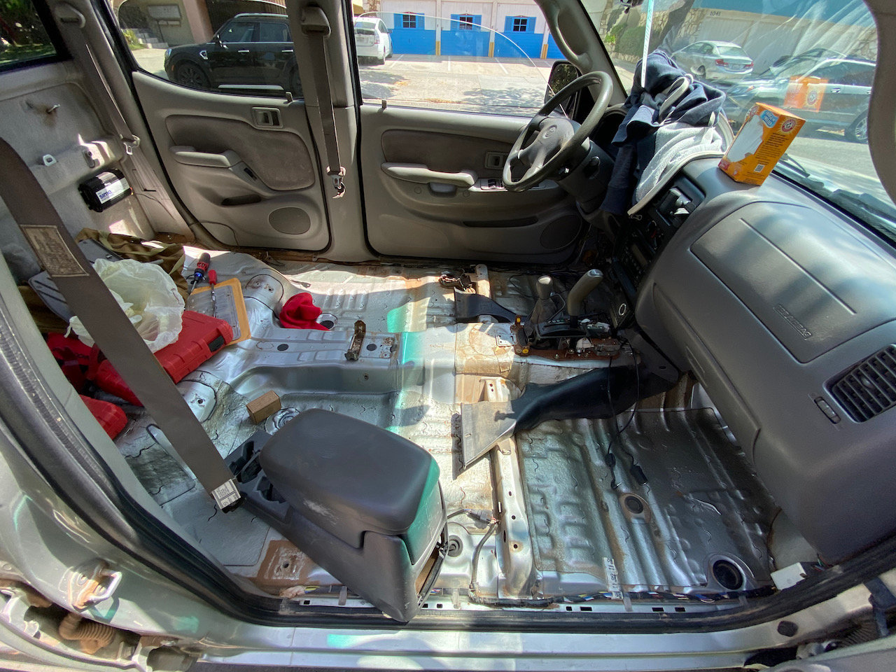

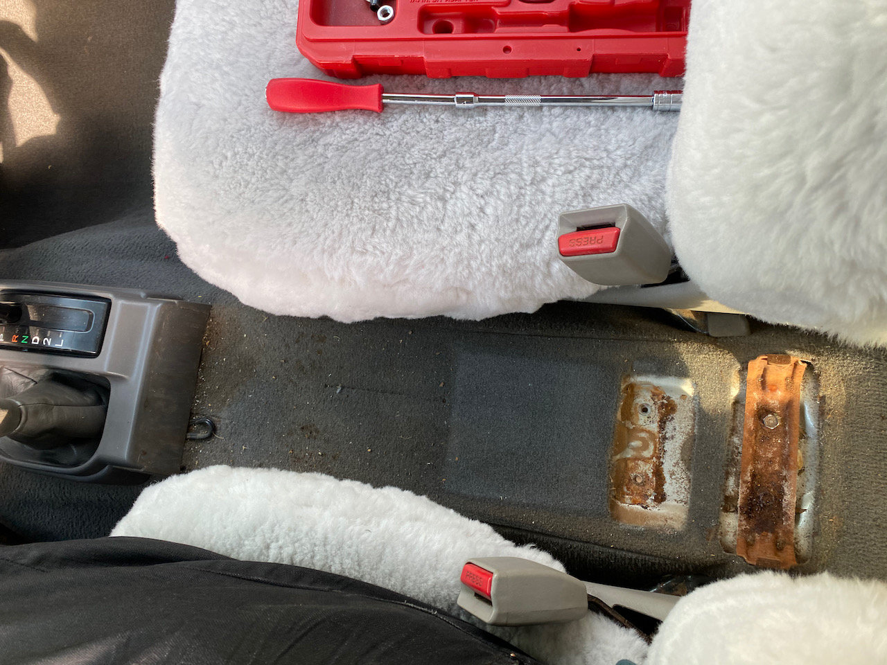

    I just removed carpet in the 2002 Double cab and let me tell you that carpet is so thin. I like the naked look actually. Carpet stinks of previous owner 20 years. So I will toss it and might order new carpet. But for now I will drive as is. Tank mode! Also found Rubbers under the carpet ?!

    As thin as that carpet and padding is, it still offers a significant amount of sound and heat insulation.
    It will sound like driving around in a tin can. If you haven't gotten rid of it yet, I'd suggest just washing (carpet cleaner and a hose will do wonders) it and reinstalling. That stuff is fairly expensive to replace.

    That looks loud.

    Was gonna say - that, and hot. That insulation blocks heat transfer and sound.

    I found carpet online for $150. Thats not expensive at all. No I have not thrown it out yet. Its in the back of my truck. If no one steals it. I will give washing it a try

    @SiberianTacos, Since you've gone that far you may as well order up some Dynamat or similar and lay that down while you're waiting on your new carpet. Oh, and give it a good scrubbing. Maybe clean and paint all the rusty parts :p

    Yeap all the rusty part were soaked in Vinegar for 24 hours and cleaned up with baking soda. Then washed. I have not painted them yet. But that will come later. I have Kill Mat and Noico. Plan is to go to car wash and vacuum out the interior give it a good wash. Then treat interior with killmat and noico. After that install the carpet. Also considering removing back seat and installing only 1 bucket seat. So I can setup my fridge on one side

    Well I listened to you and just came back from hand car wash. Placed the carpet in my trucks bed and laid it out flat Paid the coins and used high pressure soap and then fresh water. Turned it over and did the same. After that used the car wash power full vacuum and sucked up most of the water. Its now parked outside drying. in the bed of the truck. The spots that were stubborn I used vinegar and water and removed the stains. I hope the carpet doesnt smell like wet dog after it dries.. Thanks for sending me down the right path my friend!
