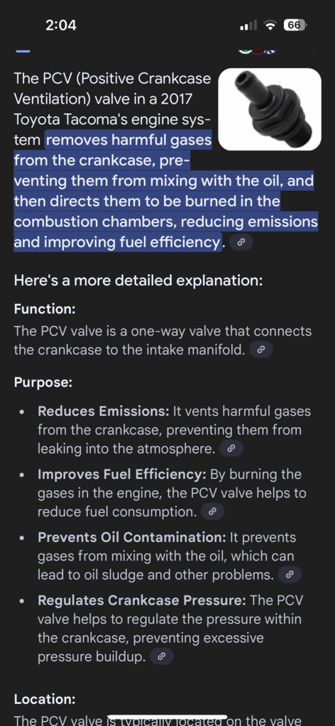

    Dang, that's stealing almost an exact idea of mine (ok, I hadn't ever shared it, so complete coincidence lol). Mine was to put the fitting on the oil filler neck, but wasn't sure if it would simply switch the issue from ingesting oil on uphill climbs to ingesting it on downhill climbs (their page says: "There are also oil drains located near the front of the cylinder head, allowing for sufficient oil drainage." so maybe the idea will work).
    That setup (by itself) wouldn't provide the other benefit that is said of catch cans, which is to extract the oil mist that flows through the PCV that dirties up the intake & valves with oil deposits. My idea was to also have a can on the line as well (the benefit being so I wouldn't have to remember to empty the can after each offroad trip, instead I could do it at each oil change).
    That said, I've never experienced any running issues from plain oil mist in the PCV on any of my vehicles, just the dust that had affected the MAF and O2 sensors and caking up in the intake when I had the K&N. So for me, the peace of mind is mostly in knowing my engine is safe while on a steep climb.

    But what I’m thinking about is, wouldn’t this introduce containment into your oil? Where is a catch can would catch at least 95% of it according to some? The stuff I saw inside the intake assembly. I definitely would not want in my oil. Or am I overthinking this? I do like the idea of using both.

    So here is a video On it. I don’t know if capping off the PCV valve is a good idea…tell me what you think

    The stuff you saw inside your intake assembly (I assume the filth allowed in by your S&B) is an entire separate thing from what a catch can addresses. There are no "contaminants" that harm the hard parts of your engine traveling through the PCV system (this aside from the oil-ingestion issue while on an incline). All it is is oil mist and some condensate that over time is said to lead to buildup of deposits within the intake and on the valves.
    The stuff you see collected in the can is often pretty groady-looking, but it's just an oil & water emulsion. I'd bet if you heated it up enough to evaporate the water, it would return to looking like normal clean (but used) engine oil).
    As for "capping off" the PCV... I haven't been inside a 2GR-FKS myself, but I wouldn't think there is a walled-off section inside the valve cover between where the factory PCV fitting is, and the oil filler neck. All that is being done is relocating where the crankcase vapors exit from. As long as the head has sufficient oil drainage at the front of the head for when you're pointed downhill (as their web page says it does), then I don't see that this can't solve the issue (I'm surprised I haven't seen this kit mentioned on here before, yay or nay... This has always been a concern of mine too when I'm out on the trails).

    OK so then how does the crank case ventilate if it’s capped off like this video shows? I understand it solves the oil going into the intake on inclines but what about the purpose of the PVC valve? IMG_2368.png

    Ah, I see what you're saying now, it looks like the actual valve itself is still left in the valve cover.
    I thought that whatever was spliced into the middle of the hose in the video might've been the valve (or a replacement valve), so now I'm wondering what that was on the hose (I don't recall the video mentioned anything about it)... If it was a replacement valve, then there should be no issue. I'd suggest give RM a call and ask them about it.
    Otherwise, if you can devise a way to remount the existing valve on the oil cap (or figure a way to splice it inline with the hose), then plug the hole on the valve cover, I think would alleviate any concern here as well.
    This is something that needs more investigation for sure.
